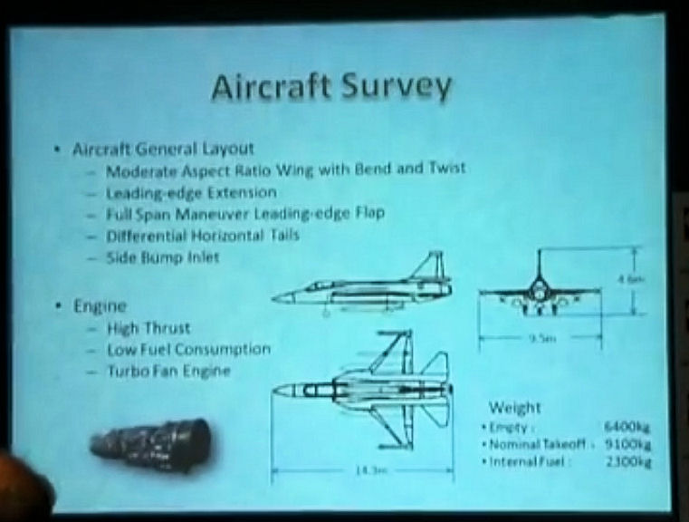

From the Dubai 2011 presentations below:
Internal fuel = (2,300/0.84) = 2,738l.
External fuel = 3,000l.
Total fuel = 5,738l.

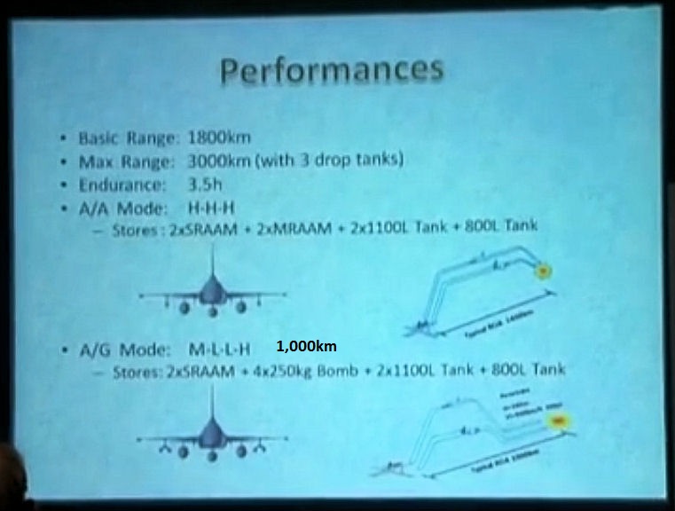

Now, this will give 1,000km range in an A2G configuration.
If you loose both the 1,100l tanks, you get rid of 1,848kg, and add 1,600kg from the two missiles. You end up 248kg lighter.
You loose the 4 x 250kg bombs = 1,000kg. You add the 2 x 200kg SD-10s. This is 600kg lighter.
In total you are now 848kg lighter.
Back to the fuel: 5,738l = 1,000km radius.
2,200l less 5,738l means 3,538l = ((3,538/5,738)*1000km) = 617km with CM-400 AKG
I have ignored the weight differences and focused on fuel.
A combat radius of 617+ km with 2 x SD10 + 2 x CM 400 AKG + 1 x 800l tank
Is that correct?
* PL5s are still missing
Still, the combat range will be greater than 617 km even when 2 x PL5s are added.
Is that correct?
