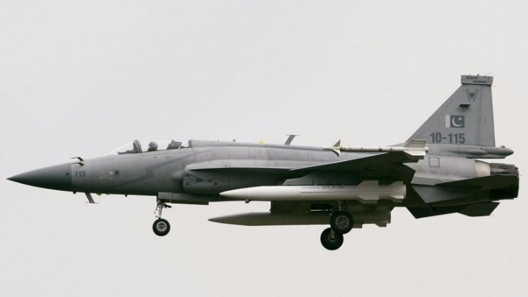

JF17 with two 400 AKG

Exactly. The question is, whether or not the range of a JF-17 with a weapon configuration shown below plus 370 kg (the weight added by exchanging YJ-8 s with CM 400 AKG s) is enough to conduct air support/strike missions for PN in every possible/expected scenario.
