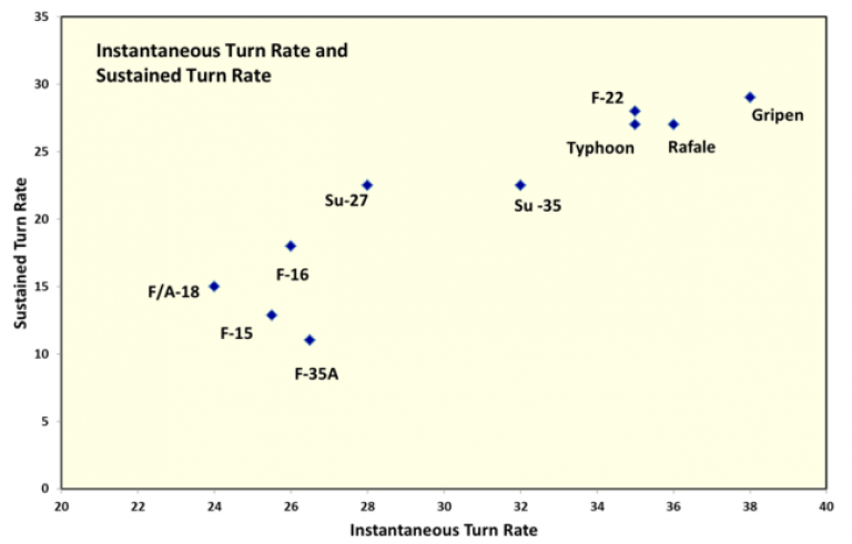

I just wanted to say something about the chart you have mentioned.
Although these rates especially instances turn rate is very much dependant on speed at time of turn. But sustained turn rate is basically turning at maximum allowed g or maximum which an air-fame can bear at corner speed of aircraft while still maintaining your energy.

Why will F-22 or even Su-30MKI not be able to match F-16 turn rate without using vectored thrust if they have a better sustained turn rate? they both are touted to have very good TWR and according to your chart much better sustained and instantaneous turn rates, they should have far more energy at that time to actually not only go vertical but even not need to use vectored thrust..
First of all, the chart is from the article, second the turn rate of F-22 might assume vectored trust is used.
