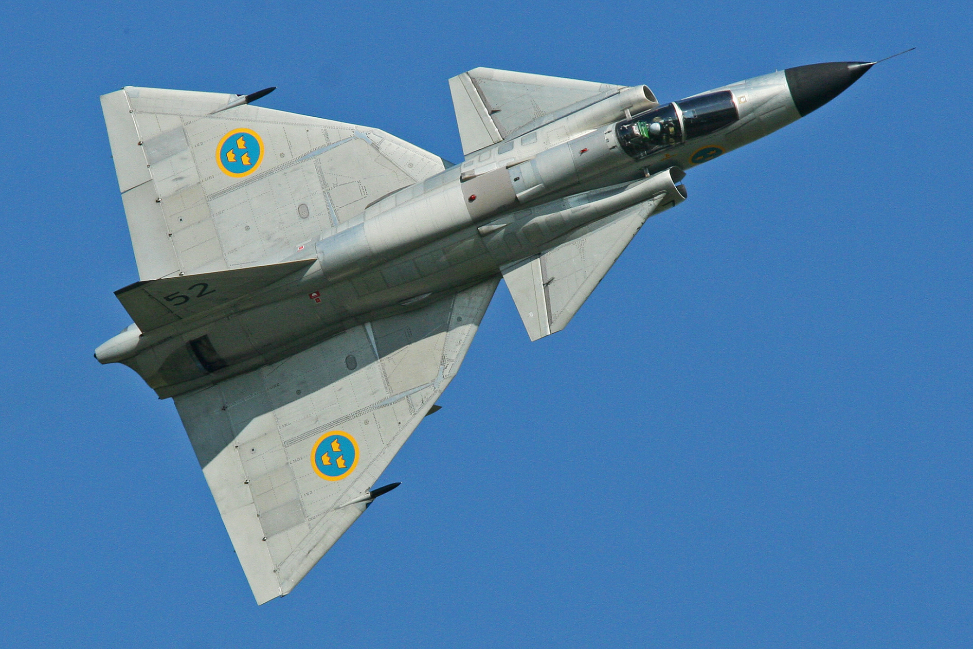

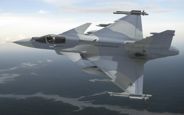

No that is not how it works. The control surface (the red part) changes the overall lift of the entire surface. Therefore it is not only the control surface, but the entire canard that generates the lift.
Fixed canard with moving control surface on viggen
Moving canard on gripen
Obviously, gripens moving canard is a much more efficient design and the lifting surface can be made smaller because the entire surface is moving.

I am not sure what you are trying to say here. The force needed to create pitch is dependent on the distance between the neutral point and centre of gravity. Hence it does not really matter how the aircraft looks like when it comes this, rather what matters really is how the aircraft is trimmed (design trimmed not pilot trimmed), meaning that dependent on where the overall lift and overall weight of the aircraft is located. The smaller the distance is between CoG and NP, the less dF is needed to rotate the aircraft around the pitch axis.

Wrong! Sub Viggan uses high angled delta wings so it's flight dynamics are completely different
The double delta wing of viggen is due to lift issues much more than flight dynamics. It has nothing whatsoever to do with my points regarding basic and fundamental flight control which you simply disregarded with a rebuttal that is not on point.

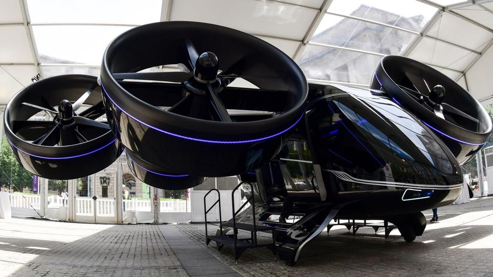

With regards to the Iranian VTOL project, do not expect a manned system. What they will probably be working on is something like this:
These VTOL systems will play an important role in future for taxis etc. In terms of military, we can use VTOL systems on our MALE UAVs. Iran does not have the funding to spend on a manned VTOL project.
Yes, this kind of VTOL is rising fast all over the world. Me prefer this one cause of hydrogen powered
