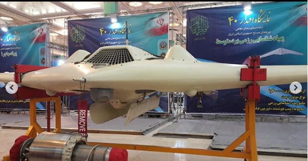

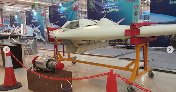

@PeeD any ideas on the origins/design of this engine?
Looks like a micro-turbojet with typical centrifugal compressor. Should be nothing important, hopefully it is durable enough to be re used often. Hence a copy of a mature and proven micro-jet should be where to search for its origins.
We first saw it 4-5 years ago.
Ok, after a look from another perspective on the engine I guess this small Jet-Saeghe did really the long range flight from Iran to Syria, reason? That mini-jet is a turbofan, mini-turbofan with accordingly optimized SFC.
Plus: It is shown with MMW radar seeker variants of the Sadid PGM. I wonder if they even managed to put a SAR into that compact airframe in which two Sadid hardly fit... then plus its long range... plus its non-runway start and landing... plus its low RCS... plus its relatively fast speed due to jet engine... plus its high operating altitude...
Could become a real revolutionary (swarm) airpower asset if that engine is durable and cheap enough.
