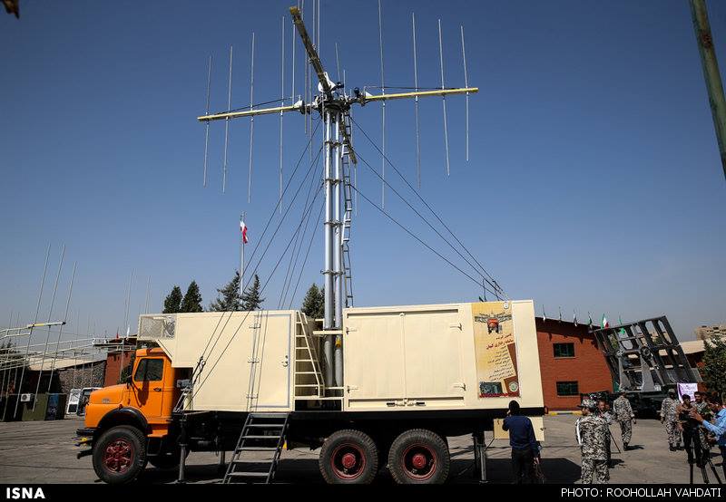

I was wondering since the release of this radar if it was a component of Bavar 373? Who knows more about this intriguing radar?View attachment 574997
Kayhan HF radar..........as it's been written on it
