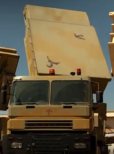

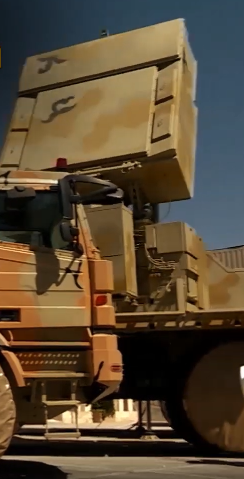

So just to clarify, this smaller array with the SLC arrays is the X-band:
And this next one with the large IFF is the S-band?
It can be said that:
- Bavar with X-band asset can engage non-stealth targets at long ranges. It can also engage BMs.
- Bavar with S-band asset can engage stealth targets at close range
- Bavar with both radars combined and intact can engage stealth targets at long range. It also gets much more robust in terms of ECM and beaming/notching.
