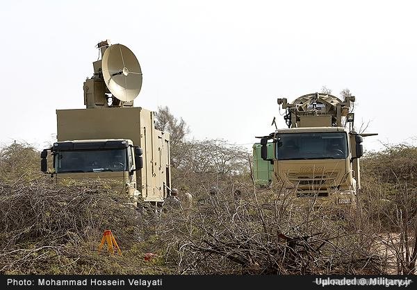

2.5 year old article about 3rd khordad and it's younger brother Tabas.
https://www.mashreghnews.ir/news/687143/شاهکار-مهم-دوقلوهای-ناشناخته-در-رزمایش-پدافندی-سپاه-دست-سوم
And most important part of this article I think is below sentences from Sardar Hajizadeh which make clear importance of 3rd khordad for Iran.
Hejizadeh called third khordad as biggest research project which end to successful result.
