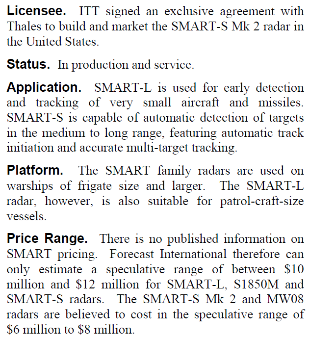

https://www.forecastinternational.com/archive/disp_pdf.cfm?DACH_RECNO=758
let's say the price is jumped up into 20-30$million range /unit , due to broker , it's still affordable with our budget .
