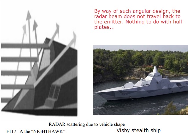

That is the overall conception of the ship design. Never ever you will see that this principle is employed on the soldered steel plates of the hull...Show me the beef (on this) ..
If only things were so easy as you are trying to portray. You are trying to simplify the stealth shaping to one of the very basic ones. Your image above doesn't displays all the incidence angles at all the surfaces and all the surface sizes. You also fail to realize that F117 was built to be stealthy against ~cm range, while ships would encounter lower frequencies. The angles on the surfaces for incident radar beam are all different for the ship and the plane. The background with which to hide the two are all different. The clutter the two intend to produce is different, one mimicking probably a flock of bird while other a small fishing boat. The plane needs a certain surface material and design for travelling through air at supersonic speeds, while ship doesn't.
And than you post a pick of a small corvette in the discussion on frigate.
French Stealth La Fayette-class frigate,check the angled and uneven sides made of radar absorbent material, a composite material of wood and glass fiber as hard as steel, light, and resistant to fire........the so called shoddy work.:D
RAM and other material coating is a different matter altogether.
Compare apple with apple and not oranges.
