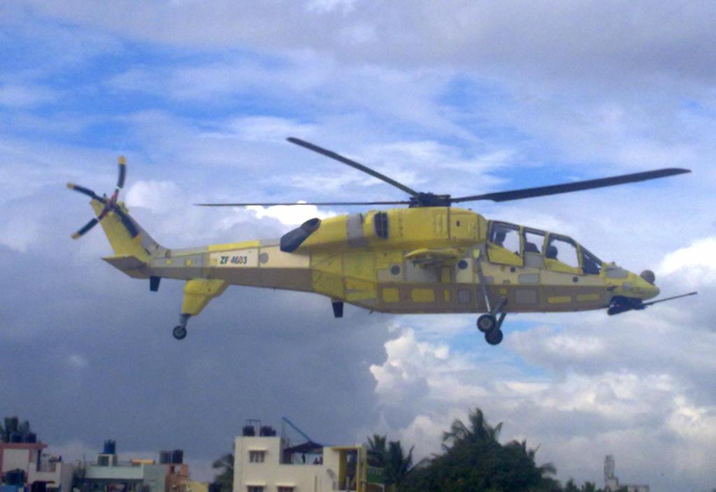

While the concept(commonality with the Dhruv) is nice, it seems a little ungainly with the tail wheel being based on an extraneous support. An inspiration for a solution exists with the upcoming AH-64 for the IAF by moving the tail wheel all the way to the empennage.. however that will put greater stress on the tail which will need strengthening.
A different solution would be a tricycle landing gear like the Hind and adding a light tail skid at the end to protect strikes.

For CTP Wg Cdr Unni (Retd), it was just another feather in his cap with the successful first flight of LCH TD-3. Explaining the new features of LCH TD-3, Unni said that the chopper has a lifting wing now making it on par with the Mi-25 and Mi-35. In addition, the HAL designers have shortened the length of the chopper to improve the vibration characteristics.
The wings are now sitting slightly on a higher attachment point, compared to TD-1 and TD-2. "The cockpit was glassier earlier and now we have fixed armour plating on the sides, reducing the glass factor. Even the height of the cockpit has been reduced. The LCH TD-3 will be soon be integrated with weapons and it will have a busy schedule ahead carrying out trials. We have improved on many features, including the gear boxes of LCH TD-3
The wings are now sitting slightly on a higher attachment point, compared to TD-1 and TD-2. "The cockpit was glassier earlier and now we have fixed armour plating on the sides, reducing the glass factor. Even the height of the cockpit has been reduced. The LCH TD-3 will be soon be integrated with weapons and it will have a busy schedule ahead carrying out trials. We have improved on many features, including the gear boxes of LCH TD-3," Unni
A problem with lifting/stub wings is that they reduce hover performance. The Commanche had found a rather unique workaround to this problem...internal bays and a very carefully designed stub wing system that would disperse the rotor wash to minimize the loss of lift.
