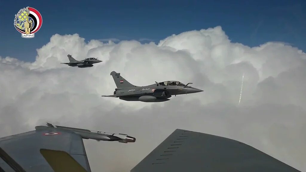

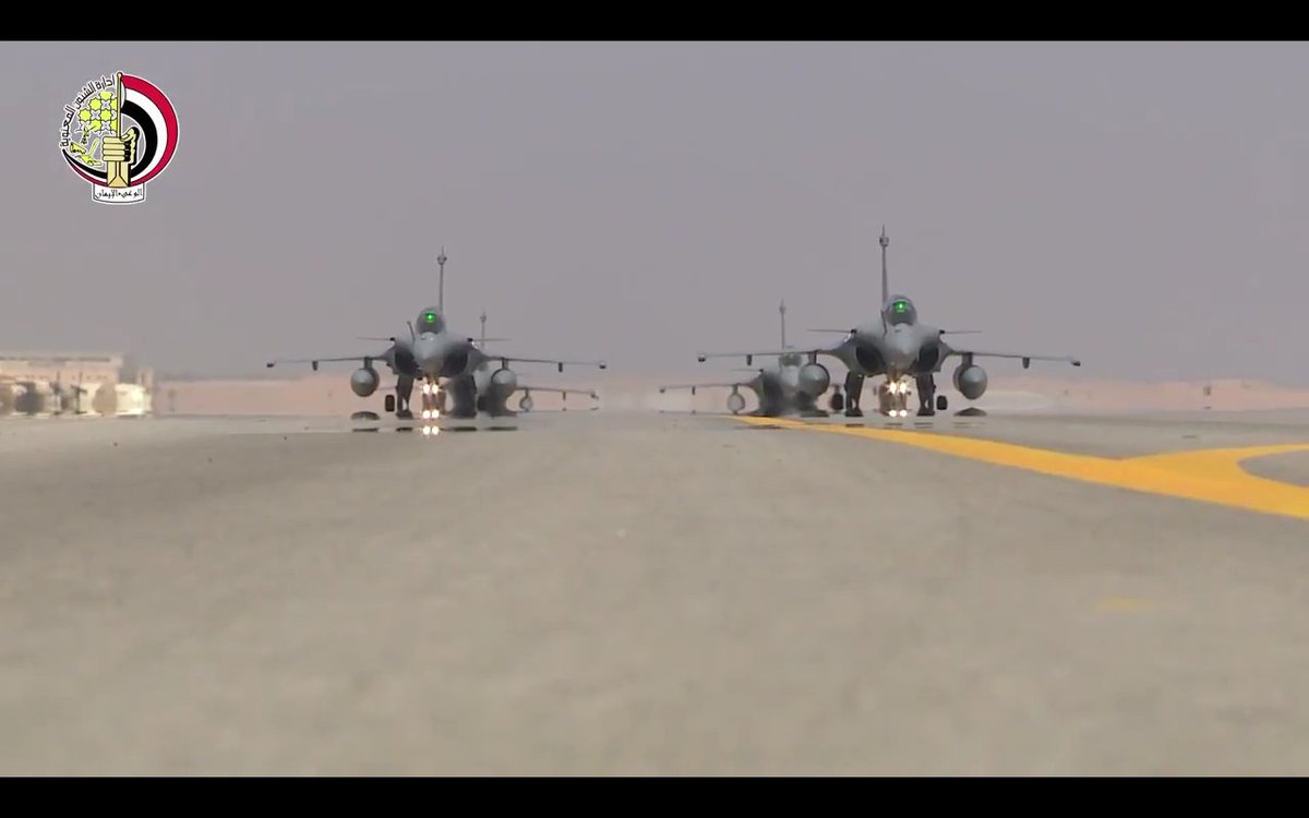

Egyptian Rafale omnirole aircraft took part in the exercise.
Flying out of Cairo West AFB under the 203rd "Silent Death" Tactical Fighter Wing STORM with the 34th "Wild Wolves" Tactical Fighter Squadron.
