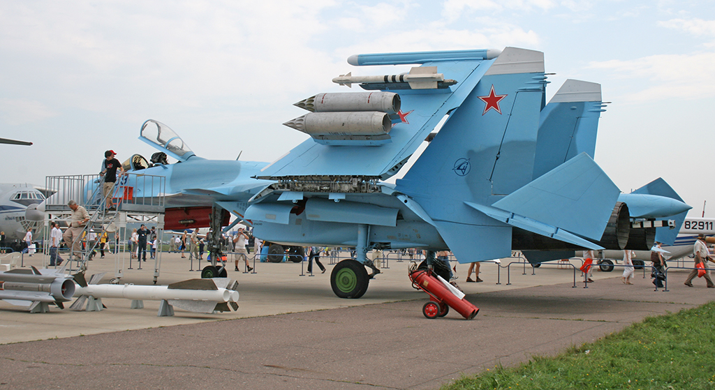

Despite it being a delta wing configuration, it's still doable. The Russians easily made the Su-33 naval variant not only with folding wings, but they also made the elevators/horizontal stabilizers partly folding as well. So it shouldn't be a huge endeavor.
Granted the wing seam would be much more complicated than ones made on the H-stabs because of the wiring and sensors for the wingtip pylons and hydraulics etc., but still very doable.
