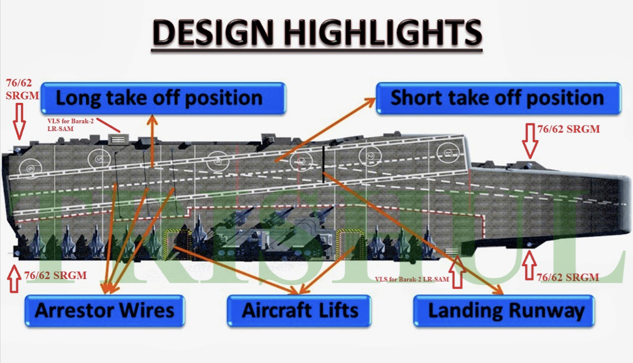

The lift size of INS Vikrant is 10x14 meters. So the width is 10 meters.
The width of the Rafale M is 10,90 meters.

10.90 meters > 10.00 meters.
That is the problem.
So either the information about the lift size is wrong, or they have done something, because the Rafale M simply does not fit on a lift 10 meters wide.
Don’t forget that you want some margin so a good lift for the Rafale should be ~13 meters wide.
The size info sounds ligit.
Fact is that India choose the Rafale despite a 10.9m wingspan. That means that a solution have been found.
