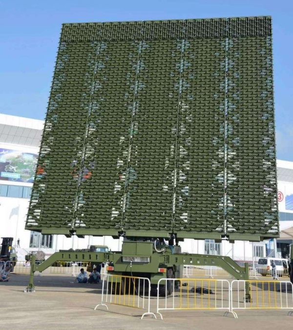

BTW the radar in the OP doesn't look like the prototype pictured in @Saudang's linked article.
Picture in the OP is probably a long wave early detection radar rather than quantum radar.. quantum radars will look much like laser weapons as they emit Photon with a possible receiver looking like a large camera lens

The device has been described as the world’s first UFH band anti-stealth radar system and also the pioneer in special high-frequency radar technology and active phase-controlled array radar coupled with a novel anti-stealth sharp device.
UFH or UHF? Typing error.

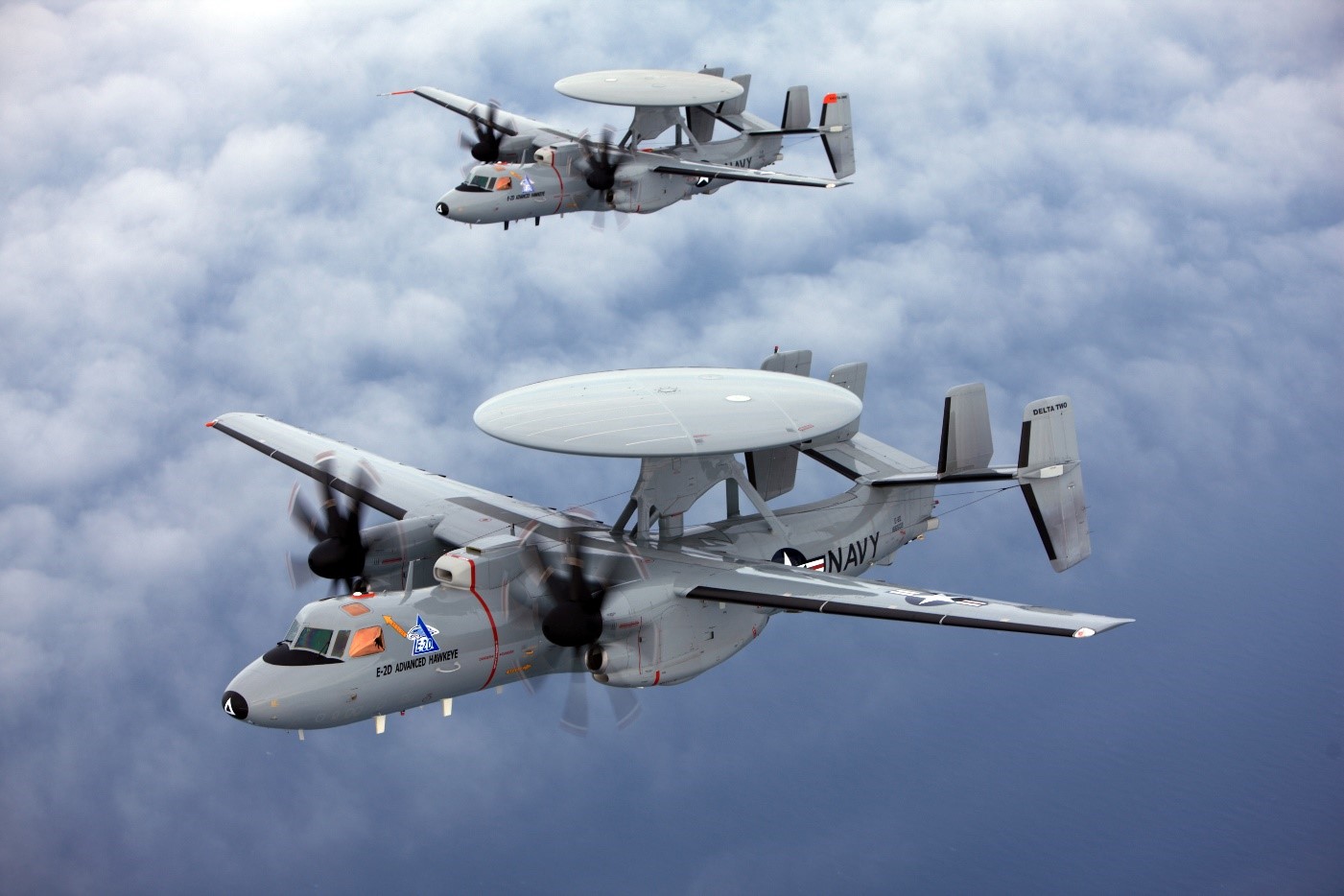

For general knowledge sake, I wanted to point out that it is not correct to tout YLC-8E as the world's first UHF band anti-stealth radar system.
E-2D Advanced Hawkeye is equipped with AN/APY-9 UHF band anti-stealth radar system. This AEW&C system achieved IOC in 2014 and FRP in 2017.
Details in following post: https://defence.pk/pdf/threads/russ...fairly-realistic-numbers.589471/post-10997370

China has recently showcased what was touted to be a revolutionary radar at the Zhuhai airshow. The YLC-8E is a significant addition to the People’s Liberation Army’s anti-stealth capabilities, a development seen as a major challenge for the US’ highly advanced F-35 and F-22 fighter jets.

The YLC-8E is the brainchild of the Chinese state-owned CETC and has been touted to be the “flagship of Chinese stealth radar”.
China’s YLC-8B anti-stealth radar.
China’s state-owned Global Times had earlier explained that the antenna of the YLC-8E is gigantic. With its high power and cutting-edge information process technology, it can detect even the most advanced stealth aircraft. It can also detect other types of targets at long range and high definition with its key parameters superior, making it superior to foreign competitors.
The YLC-8E has the basic features seen in any 4th-generation intelligence radar. It can be leveraged to provide critical combat command systems with actionable intelligence, integrate the intelligence collected, and even intercept aerial threats and hostile weapon systems. This stealth reportedly possesses independent guidance capabilities as well.
