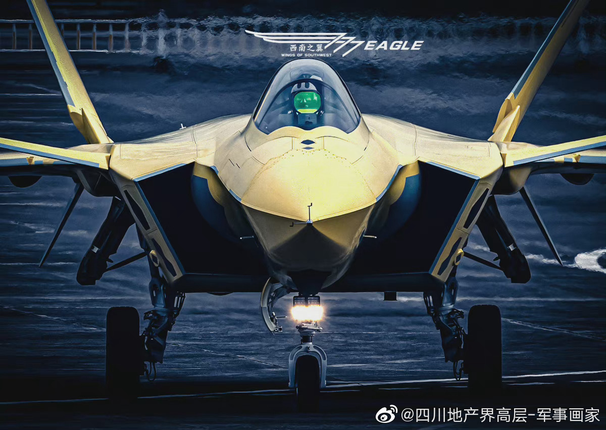

I'll be honest, I dreaded ever since the twin-seater was rumoured that it would come out looking ugly as sin. It's not nearly as bad as I thought it would be.
Those new features below the hexagonal vents are interesting. More datalink antennae? That would fit in with the MUMT drone controller role that's speculated for this variant.
I'm also happy that this and the J-XY have finally emerged. I considered them lower-tier developments that hogged the spotlight from what we really want to see: the WS-15.
