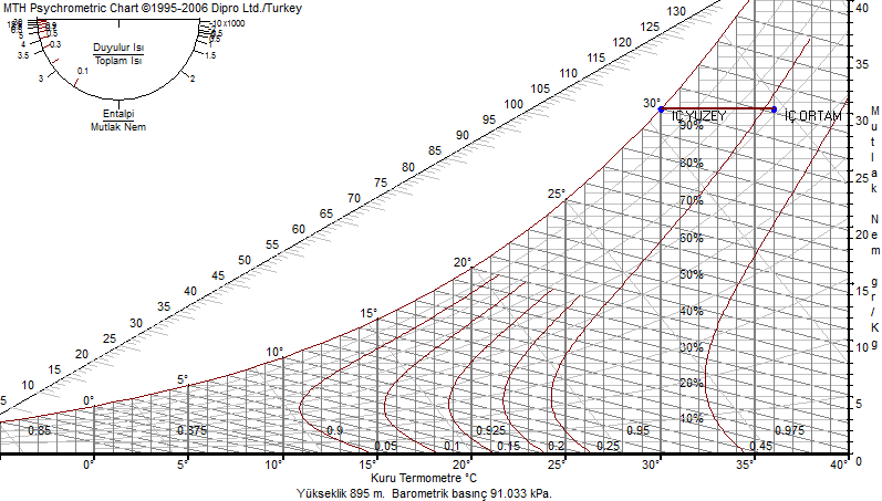

Mate let's say your the Air in your suit is 36 Degree Celsius and %50 RH... and you began sweating... Air in the suit will absorb some of your evaporated sweat and at some point it will hit "condensing point" after that point your sweat won't be evaporated and you won't be cooled. Your body temperature will rise, so the air around you..it will move on the "Yoğuşma çizgisi" (curve at the left of the diagram and it will reach way above 36 degrees. ) :)
i know this chart, had used it lectures about HVAC ,also one project related to it, to make one code which generates the chart at desired pressure ,so i got your point about that :) . But it was hard moment to use calculator instead of chart when lecturer gave questions in different pressure than provided as attahchment in exam :argh:.
If textiles inner surface is cooler than air sealed between textile and skin (lets say 30-31 ) , vapor will be condensed on inner surface while even %70 RH in the air @36 C. Thus can transfer this water to feet by some fibres to disposal
this makes me feel fun :yahoo: also annoyed
i know this chart, had used it lectures about HVAC ,also one project related to it, to make one code which generates the chart at desired pressure ,so i got your point about that . But it was hard moment to use calculator instead of chart when lecturer gave questions in different pressure than provided as attahchment in exam .
I know your pain bro. :D
True.. Question is how will you keep it at 30 degrees ?
And here is the calculation.
It is %71.32 relative humidity...:o:

İ just assumed outside to be lower than 30 (+2 ) degress :undecided: , proabably this suit will be used at night ; thus temperature wouldnt be high as its in daytime ,and places around world it might go lower than 30 (except tropical ) ,i tried to find nighttime maps but unfortunately couldnt find.
They claimed to manufacture nano-tech textile, so they might achieve an inner surface to be at a level lower than 36 in a level, to absorve heat generated by human. By this way outer surface will be at ambient temperature which is 30-31 at max , an inner temperature which is near to it.
actually vapor will leave heat to inner surface of textile, temp gradually fall to outer surface as conducted. they need to achieve a material which works in this way whatever ambient temperature is ( while lower than 36 )
