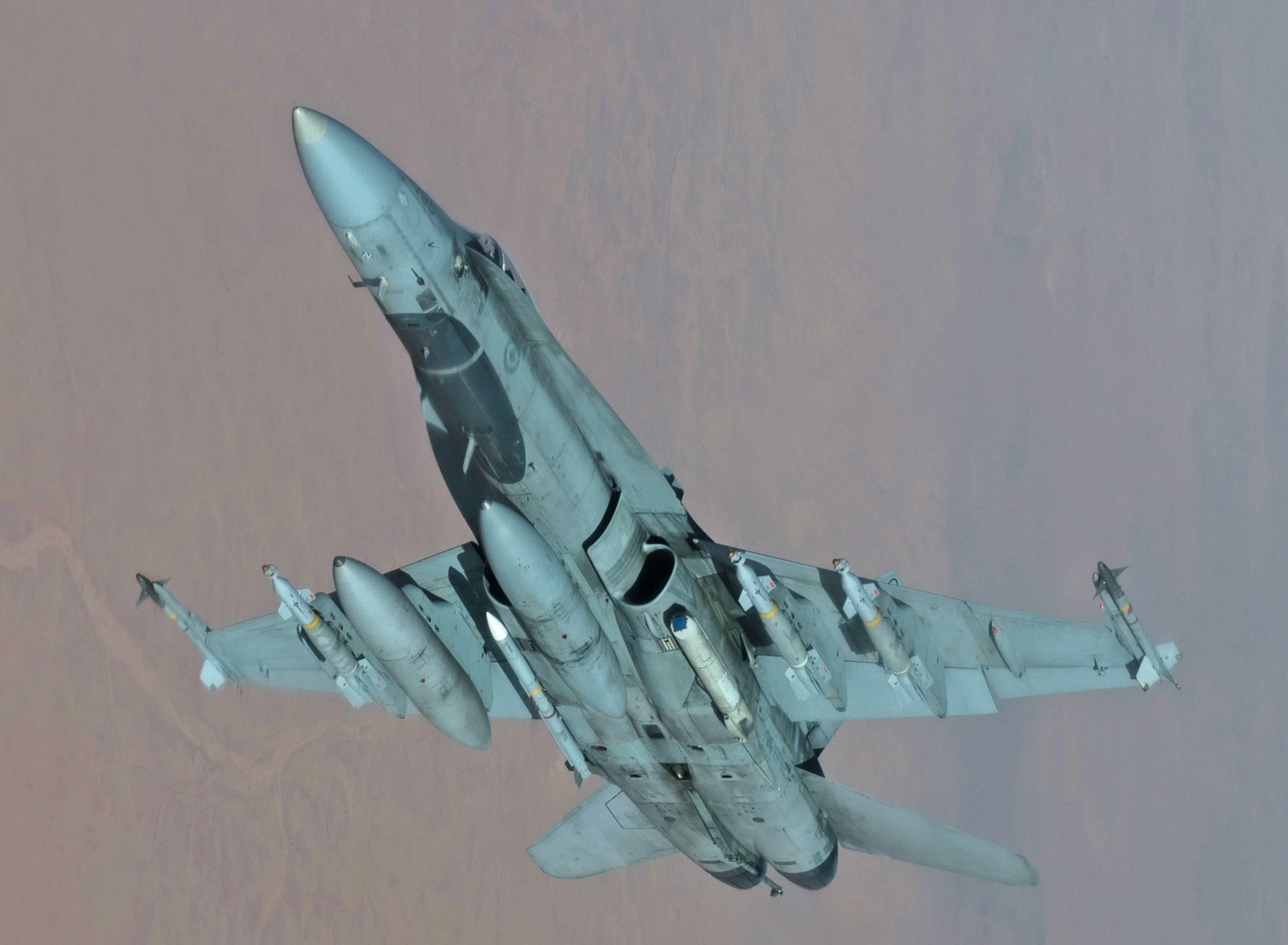

Firing AG missiles with delay is very very normal,if you think AG missiles are always fired in pair you don't know anything about fighter flying
As far as bombs like Mk84 are concerned I have never seen any being dropped in single profile,they are dropped always in pairs
OTH likes of GBU 24 can be launched in single profile
Both are heavy bombs but why the difference? Its just because both are used for different purposes and scenarios, usually with dumb bombs you will be dropping those over a single target in one run while in case of GBU 24 you can drop it over 2 different targets in one or even two runs,so issue is not the bomb type rather the scenario
Now if you think likes of MK 84 or GBU 24 aren't heavy or wont cause much issue for the aircraft in stabilization then let me tell you..even if you fire an AGM 88 from an F-16,which is much much lighter than the bombs discussed above,it causes a bit of stabilization issue for the aircraft and it can be easily overcame by putting the aircraft on AP or trimming..and same for GBU 24, aircraft can easily be balanced even if not dropped in pair
So please, correct your facts... Missiles and bombs can be dropped in single and pair profiles,it totally depends on the scenario you are flying in..
