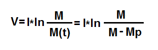

For sake of simplicity I neglect gravity and drag forces. This is a formula of rockets final speed:
I = specific impulse or exhaust gasses velocity, M - total rocket mass, M(t) - final rocket mass, Mp - mass of the propellant. Since typical exhaust gasses velocity is about 3000 m/s, we get this simplified formula:
All we need to know for our calculations is total mass of rocket (M) and mass of propellant (Mp).

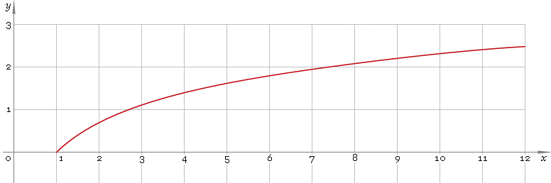

Its a logarithmic function, which looks like this:
Here we see two problems of single stage rockets:
1) Its almost impossible to increase M/M-Mp ratio more than ~15 times (if we add more fuel we need to add weight to fuel tanks and add engines).
2) The growth of logarithmic function slows down quite fast, so increasing that ratio does not make much sense anyway.

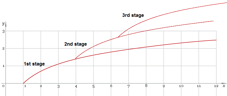

So currently the only solution is multistage rocket. Here how it works:
Second solution is increase specific impulse, but its simply not possible with chemical powered engines, while nuclear and ion engines have not enough power to lift the rocket from the ground. They are good only in space.
