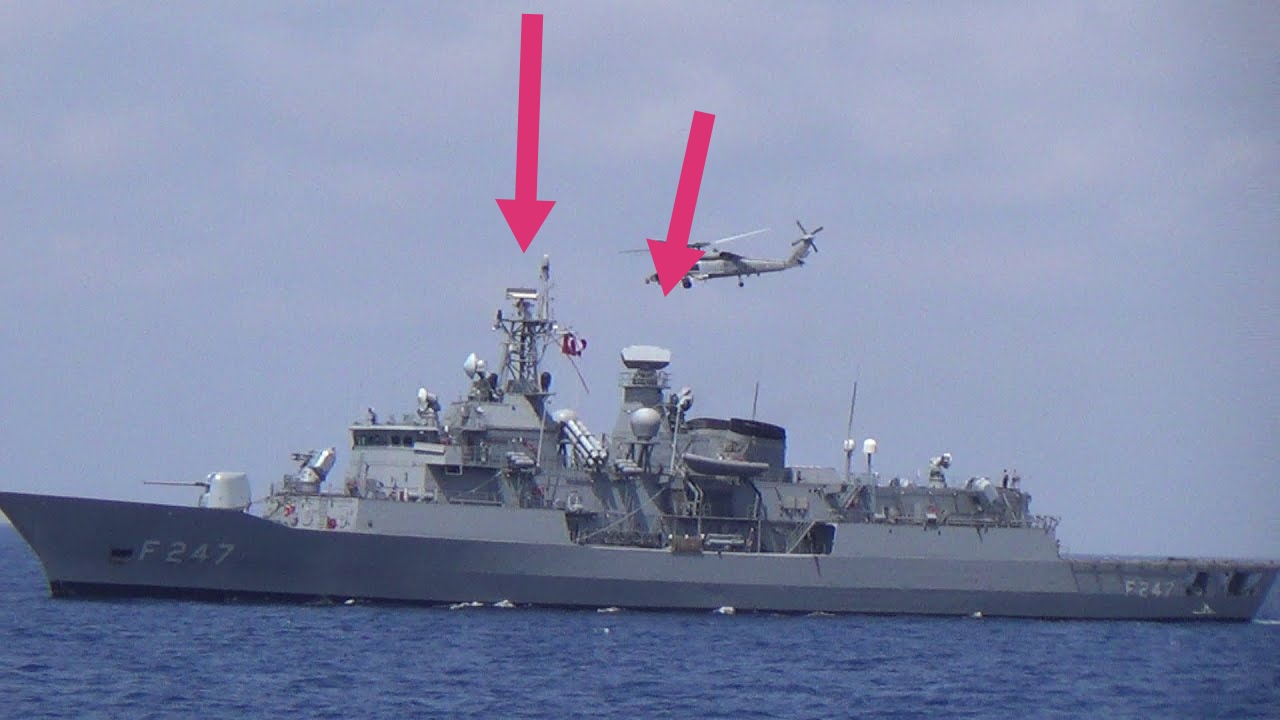

Half-Life Modernization Project will bring second radar to Barboros class frigates. Its fvckng great.
Smart S plus MAR-D X band radar in one ship. They seem to be great air defence platform. What a pity those frigates need more serious SAM than ESSM. At least aster 30.
Smart S will be moved onto first mast with EW and ES pod, at the back will be MAR-D .
There was already a second radar for sea zenith (sea guard) its being replaced with mar-d for gokdeniz.
Yes MLU will include MAR-D.
Weird how it isn't used on the I-Class but they included it for MLU of the Barbaros.
Both use ESSM. So why no MAR-D for I-Class?
Maybe it is necessary for Gökdeniz? But then again I-Class is gonna be equipped with Gökdeniz too.

I class has been designed with phalanx, if its not sold to us they will switch to gokdeniz so for the latter case mar-d will be on I -class as well.
I stated since starting of barbaros mlu. This for deployment of long range sam . Looks like navy want a use barbaros claasses like stop gap light air defence frigate .
But there is one small problem on here; 16 vls isnt enough. Maybe we can add a 8-16x vls behalf of front ciws or side of aft vls . Or maybe siper is a doublepack missille
Front of the front ciws wouldnt be suitable, the main deck has already been cut through at several locations about that area and it would affect the strength adversly.
With which system they are going to detect-track targets from a distance guide long range SAM ensuring it intercept? Yes mar-d could do that with limited range but still wouldnt worth. If we have radar suites or missiles to establish such an air defence layer, navy would have ordered I class to be equipped with them instead of an expensive MLU for an aged ship, which will become out of the service after 15-18 years.
What is confusing is, after the mlu barbaros class is going to have essm, gokdeniz and phalanx for point defence and it doesnt seem normal to have three. That indicates the vls might be used for some other purposes in the future. Or as an extra layer of defence for tcg anadolu.
No need to dig in for complexities, we need ships, we are going to establish a flotilla soon and we definitely need ships that we even try to squeeze out the last juice from burak class.
Gokdeniz also has own STIR..

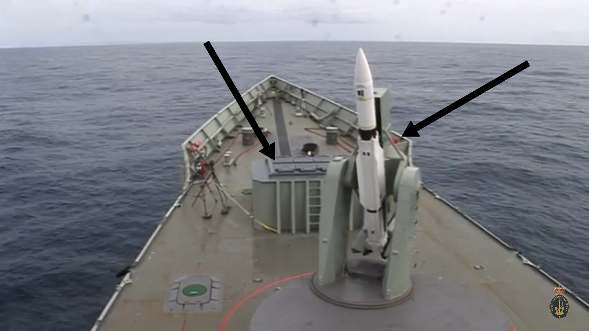

Would take a week at most, to fit another Mk41 in there. There are 2 slots for 2 of 8 cell vls, they are just not using the slot on the port side.
Anyway, my hopes for my avatar are increasing:yahoo: i will dream about Gabyas and SM2s also.

My argument was ESSM doesn't give area defence as SM2. I would say ESSM with limited range for point defence.
You could get 64 cells with quad pack option. I don't think TN purchased quad pack.

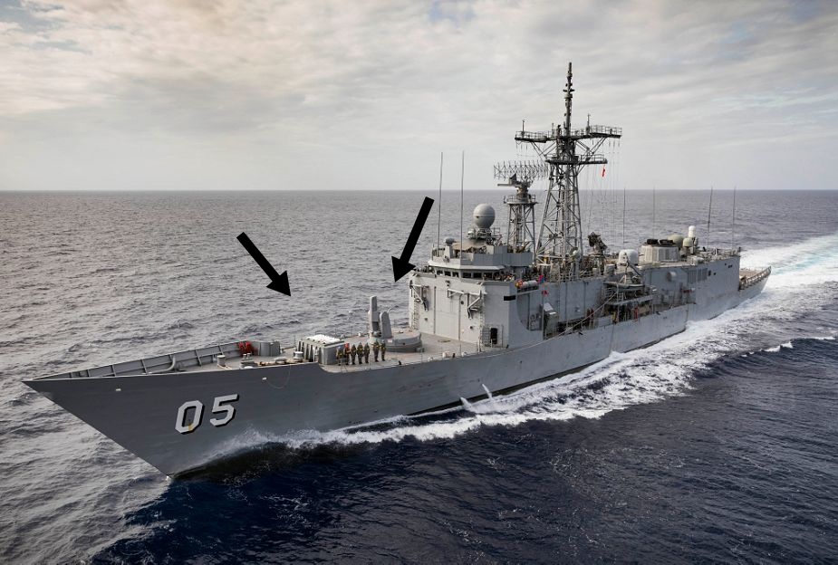

Here is the frigate can launch SM-2.
https://en.wikipedia.org/wiki/HMAS_Newcastle_(FFG_06)
Gabya class had AN/SPS49 radar and mark92 fire control system. Turkish navy mustn't have destroyed them. So Gabya class frigates need missiles, software and some little equipments for running SM2s.

Upgrading Gabya class with early genSM2 Gabya class is still theoretically possible. If US sold , upgrades would be cheaper than buying Aster30.
Australian Navy upgraded their perry class frigates with sm2 for xxxxxx(edit: inaccurate info)usd. One Aster 30 system costs 500million EUR.

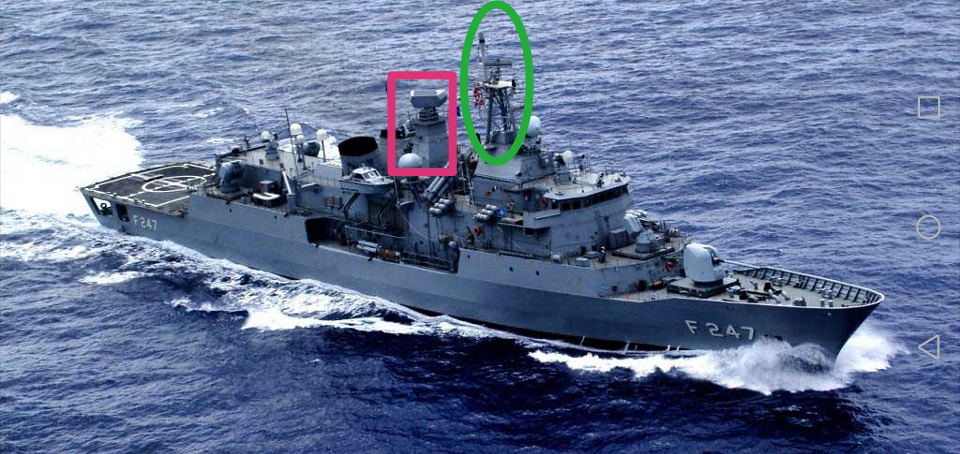

But you also must be aware gökdeniz was based on korkut which also relies on a 3-D search radar.
Check this part:
"The AWS-06 Dolphin 3D search radar, which is an integrated part of the Sea Guard CIWS System, will be replaced with Aselsan’s MAR-D radar. The Ku-Band TMK Tracking and Fire Control Radar will also be removed."
Apparently, sea zeniths has relied on a 3-D search radar. If you check pictures of gökdeniz ciws from the tests you will realize there is a search radar atach to that, on counter side of fire control radar:
https://www.aselsan.com.tr/GOKDENIZ_CloseIn_Weapon_System_1178.pdf
Check out MLU's gökdeniz and you will only see fire-control radar on that.

You are wrong mate. We already changed aws-9 dolphin radar with smart-s mk2 radar. So ciws takes radar picture from smart-s mk2 and track and lock him with his own fire controo radars.
images
On the other hand Gökdeniz have two diffrent version. One of that uses fire control radar + mobile searc radar ranged 65-70 km that is not mar-d ranged 100+ km. That is a autonomus version. İf ship hits from radar system contiune the work. But that is expensive version.
There is another version here without mobile search radar Only with fire control system. That system uses ships main radar for target searc and seek and lock him with his own fire control radar.
https://www.photobox.co.uk/my/photo/full?photo_id=502980650830
Just look st that photo Gökdeniz on barbaros mlu only have a fire control radar that is the mean this is a ship intagrated version. So how ciws uses smart-s mk2 before the mlu, Gökdeniz will uses smart-s mk2 after that mlu. As you know smart's already operates ram's on milgems.
