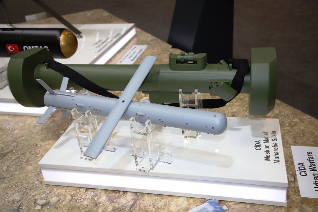

Roketsan invested its R&D money also in another infantry system, of bigger dimensions. Known as Cida, it is defined as an “enhanced smart rocket,” this because the projectile is guided only by an inertial measuring unit platform, CEP being around 5 meters. The firing sequence sees the soldier activating his sight, aiming it at the target, squeezing the locking trigger, waiting around three seconds allowing the algorithm estimating the target point to complete its task, then the firing trigger is squeezed. This activates the soft launch system, which is fitted into the expendable launching tube but is separate from the projectile. During the flight the Cida reaches a maximum speed of around 100 m/s, the IMS activating the rear cruciform wings in order to guide it towards the target, the lift being provided by the main wing that rotates after launch to become perpendicular to the missile body.
The launch tube diameter is of 90 mm, its length being 1 meter Roketsan to exploit the warheads developed for the Cirit guided rocket system, which include a multipurpose warhead (blast fragmentation, incendiary and armour piercing), a thermobaric warhead, and a high explosive blast fragmentation. The warhead takes around 40% of the total length of the Cida projectile. The current range is of 750 meters, however the final product should increase it to 1,000 meters, the type of guidance allowing using the Cida mostly against static targets. A first flight test has already been carried out, further testing being planned to confirm the system reliability and performances, a full prototype being expected for late 2019. Some upgrades are already being considered, beside the range increase a better man-machine interface is being studied. The current system does not allow firing from enclosed areas, however this is one of the next steps together with the possible adoption of a semi-active laser guidance, the latter considerably reducing the CEP.
