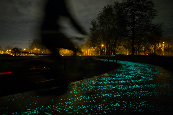

Studio Roosegaarde
The potential is pretty huge. Not only could the roads generate enough electricity to power local households, but they can also provide some amazing lighting opportunities. Last year a solar road was installed in the Netherlands by design lab Studio Roosegaarde, which sucked up the Sun's energy during the day and then guided cyclists at night using beautiful Vincent Van Gogh 'Starry Starry Night- inspired LED lights.
