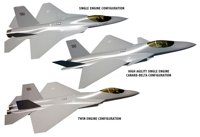

IMHO. Turkey needs to go for a twin engine aircraft. Tomorrow if you need a jet with carrier application, you would be able to adapt it to your needs much more robustly.

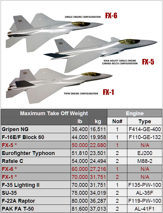

Boss you mean the first one is Airforces choice the third one is for tai's choice =) and what is your decision 1st or 3rd =)
View attachment 148037 Boss you mean the first one is Airforces choice the third one is for tai's choice =) and what is your decision 1st or 3rd =)
If Turkey agrees on F-135 engine (43000lbf) for single engine configuration, It is OK but TAI voices concern over USA export regulations for their newly and strongest engine to be exported for Turkey.
Twin engine configuration, It is Eurojet offering EJ-220 (20000lbf each) engines but Two of them will not even enough to provide a satisfied thrust for TAI's heaviest twin engine configuration TF-X so Model selection is completely depends on thrust power of engines to be selected.
FX-1 is the name of twin engine configuration...
F-22 T/W ratio: 70000lbf/38 tonnes: 1842,5 lbf/tonnes
Eurofighter T/W ratio: 40500lbf/23,5tonnes: 1723,5lbf/tonnes
FX-1 with EJ-235 T/W ratio: 47000lbf/29,4 tonnes: 1598,5lbf/tonnes
F-16 Block-50+ T/W ratio: 28000lbf/19,2 tonnes: 1458,3 lbf/tonnes
FX-1 with EJ-200 T/W ratio : 40500lbf/29,4 tonnes: 1377,5lbf/tonnes
