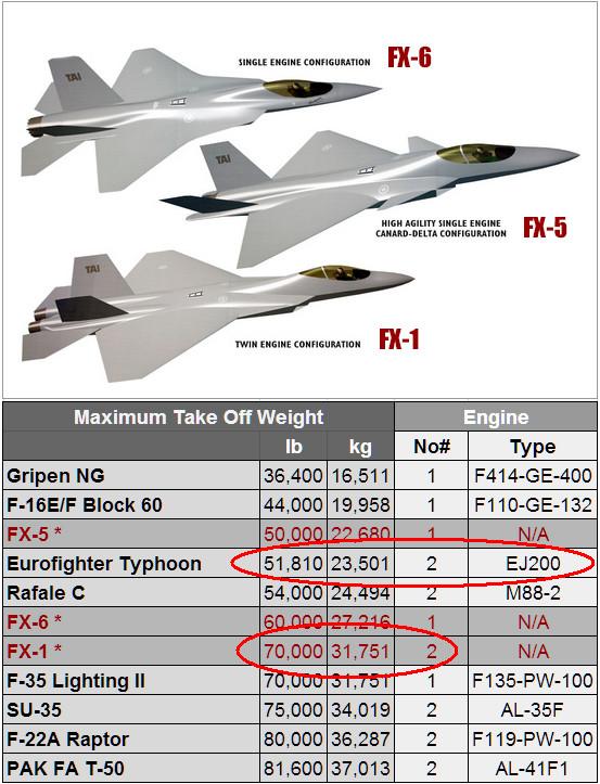

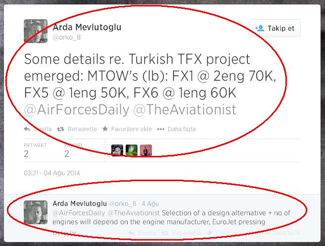

He says Selection of design alternatives will depend on engine manufacturer and Orko gave avarage take off weight of three concepts.
Eurojet pressing because Eurojet offered EJ-200 motors for only twin engine fighter concept which is coded as FX-1. Integration of Eurojet EJ-200 to other concepts with single motor requires additional modifications so Eurojet motor means FX-1 model selection.
Cabatli can you make these different option's code names clear...
Twin engine is FX-1 what about 2 others ?..

So,what other choices do we have then,when the EJ-235 is not suitable?FX-1 will have a MTOW around 60,000lb and 70,000lb. 70000lb is the max limit, not optimum and certain one...
EJ-200: 20250lbf
EJ-230: 23500lbf
Consider FX-1 as 65000lb for example...
FX-1 with EJ-200 T/W ratio : 40500lbf/29,4 tonnes: 1377,5lbf/tonnes
FX-1 with EJ-235 T/W ratio: 47000lbf/29,4 tonnes: 1598,5lbf/tonnes
F-16 Block-50+ T/W ratio: 28000lbf/19,2 tonnes: 1458,3 lbf/tonnes
Eurofighter T/W ratio: 40500lbf/23,5tonnes: 1723,5lbf/tonnes
F-35 T/W ratio: 43000lbf/31,8tonnes: 1352,2 lbf/tonnes
F-22 T/W ratio: 70000lbf/38 tonnes: 1842,5 lbf/tonnes
