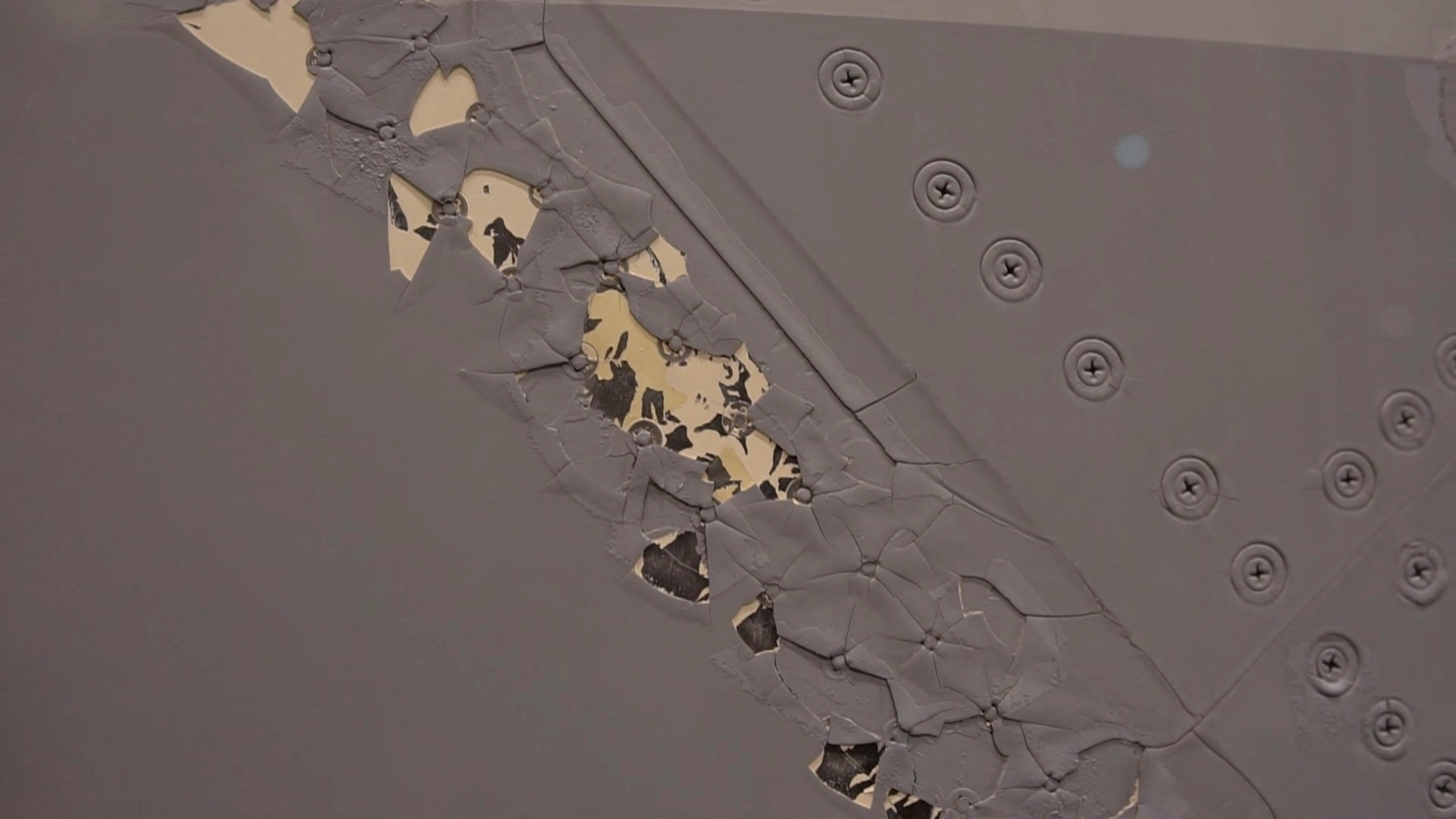

PARIS, Jan 21 (Reuters) - Qatar Airways took a $4 million-a-day dispute with Europe's Airbus (AIR.PA) to social media on Friday, publishing a video of the scarred exterior of grounded A350 jets that the airline said underscored "serious and legitimate safety concerns."

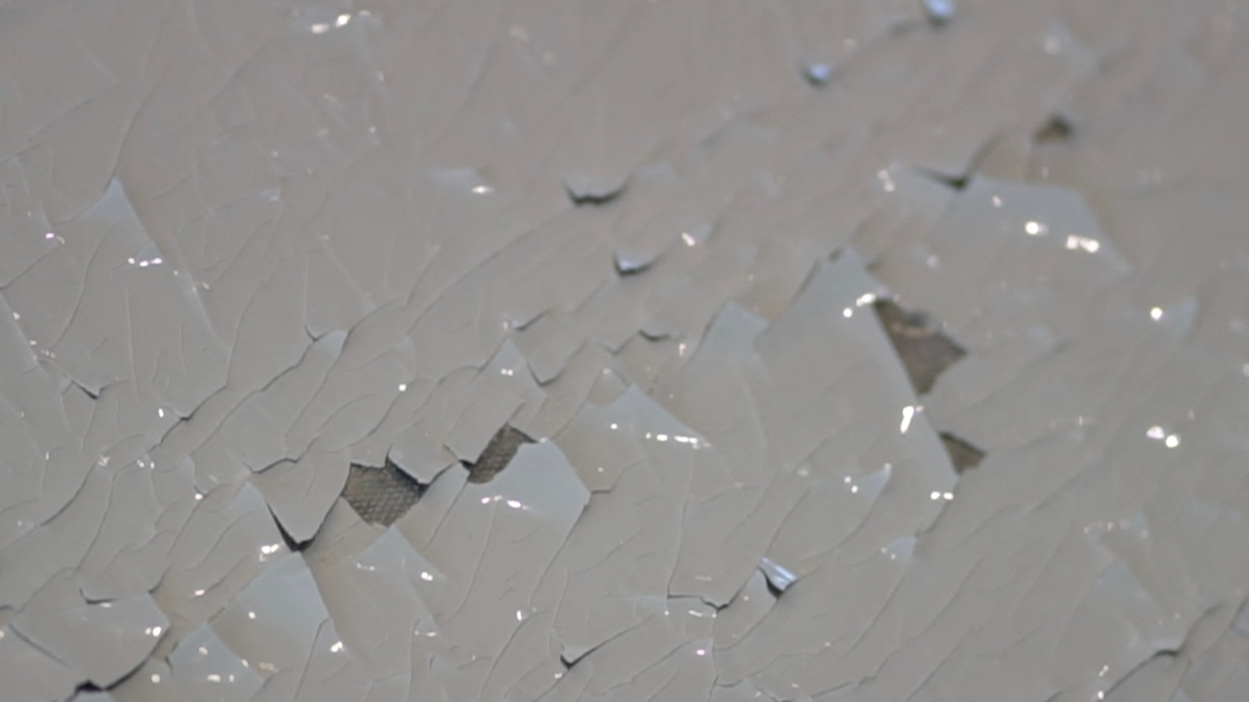

The two sides have been locked for months in a spiralling dispute over deterioration to paint and anti-lightning protection on the passenger jets, which Airbus has said is happening prematurely but does not represent any safety issue.

In the video lasting just over a minute and a half, Qatar Airways showed degradation on two A350s grounded by the country's regulator.
Airbus has said there is "no reasonable or rational basis" for the groundings, which have not been matched by operators of A350s in other countries. read more

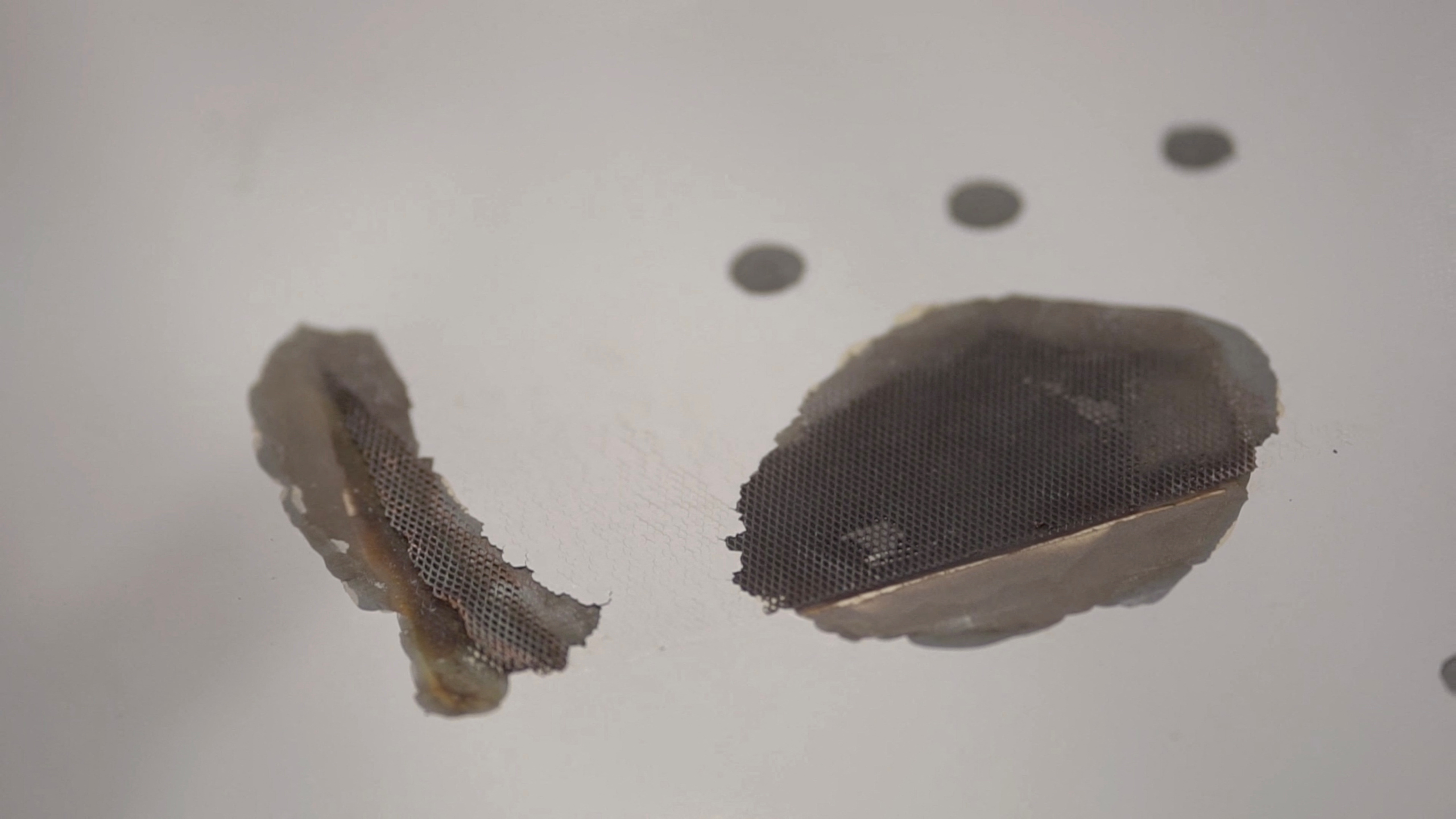

The clip showed peeling or missing paint and damage to underlying anti-lightning protection, as well as what the airline described as patches of the underlying structural carbon-fibre exposed to moisture and ultra-violet light.
