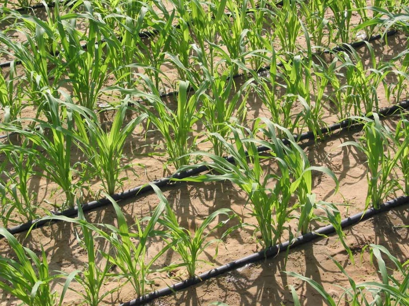

DRIP IRRIGATION….IS THAT LIKE, DRIPPING WATER ONTO PLANTS?
Drip Irrigation. To understand what drip irrigation is, we need to start with the basic concept of irrigation. In a nutshell, irrigation is getting water from artificial sources (so not rain) to crops. And there are many ways to do this, from sprinklers in our gardens to flood irrigation, which is basically the flooding of the irrigation site to get the water evenly to every area.
However, these methods are not the most efficient. Using sprinklers to water our gardens results in water being lost through runoff, evaporation, and to the wind. It also results in areas without plants being watered, which could result in weeds and fungi. This is also true with flood irrigation, as it is not efficient to flood the whole field to get the water to the plants. And this is where drip irrigation comes in. It is a system where pipes are used to carry the water along the ground to the plants, and the water is deposited slowly (hence the ‘drip’) only at the root of the plant. Think of it as shooting one expertly aimed arrow at a target, rather then an amateur loosening of arrows towards the target, hoping that one of them will hit.

Benefits of Drip Irrigation:
-Less water lost to evaporation and run off -> water conservation!
-less fertilizers and pesticides needed -makes plant healthier as the rest of the plant doesn’t get wet -> no fungus or mold
-more crop yield
-low operation costs
-The land does not have to be level or regular shaped, unlike sprinkler systems where the reach of the sprinkler cannot cater to irregularly shaped land.
An example of irregularly shaped ‘land’…and fyi drip irrigation can also be used in gardens, and large flower pots
But as with most things in life, there’s no such thing as a free lunch and in this case, our lunch money takes the form of the disadvantages of drip irrigation.
-The pipes are susceptible to damage from rodents and other creatures
-You can’t really see it working, so you can never be sure if the pipe is blocked at some point
-High initial cost to set up
However, in my opinion, the benefits far exceed the costs. Drip irrigation is a great way for water conservation, and it can be used in large agricultural ventures, as well as on a smaller scale in our gardens.
Drip irrigation can be used for all sorts of plants and crop, like fruit and vegetable crops also even rice and wheat source: media.culturemap.com
