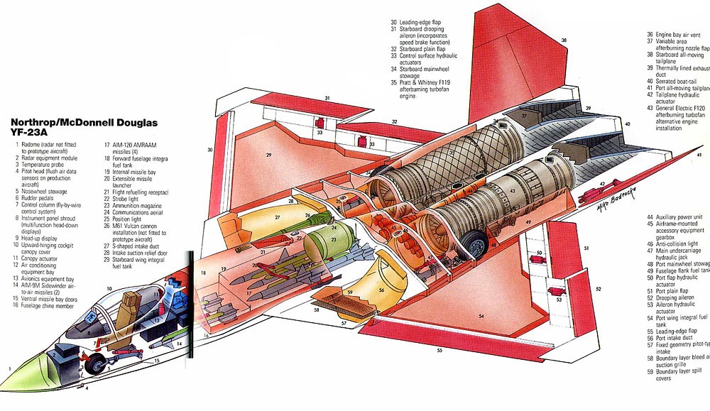

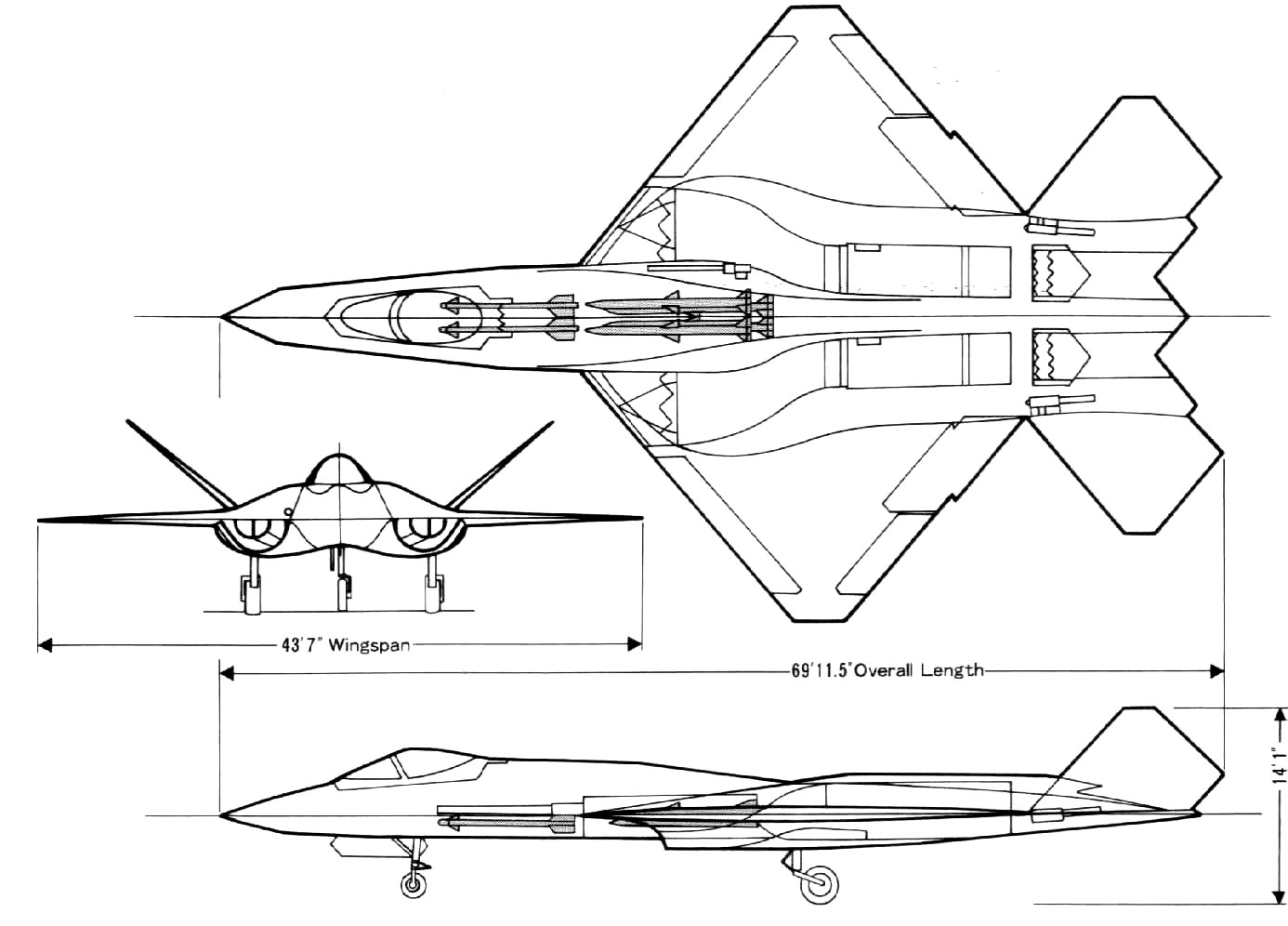

On a related note, the YF-23 design provides a lot of (structural) room for upgrades precisely because it's a little oversized. I kind of like that the PAC is looking at it. At the very least provides a very good/refined baseline to jump off from.
Right but the ACM yes said twin-engine quite clearly.

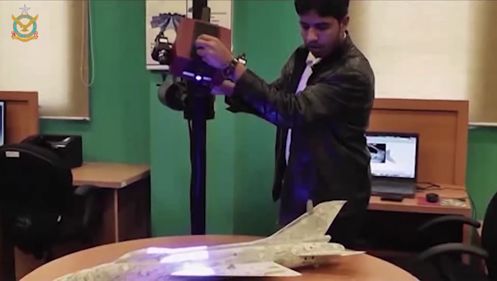

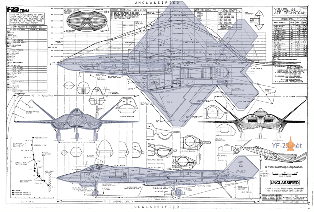

If you go a couple of pages back there are screenshots from the 6th September show I believe where PAF showed off the development of the Azm. There were a few screenshots with some analysis of the YF-23 being done- low-fidelty CFD and flight dynamics analysis using DATCOM. That's where this discussion started off from.

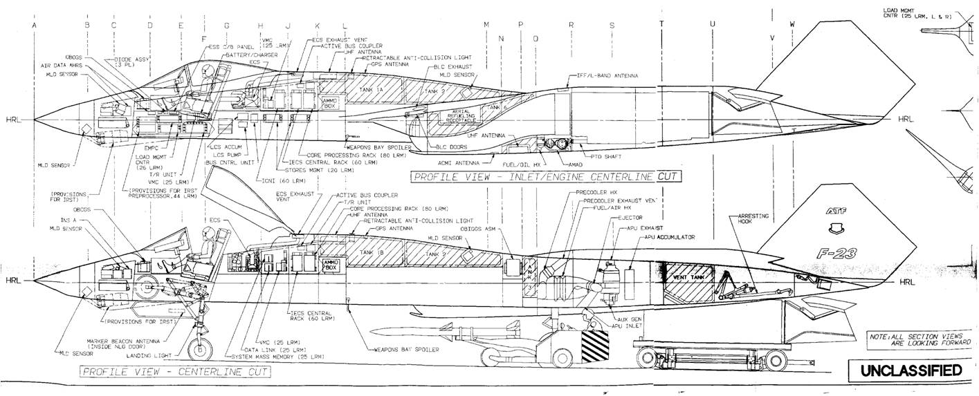

I found a high-res image (I have an even higher res but that cant be uploaded due to forum rules) that might be of interest to engineers here:
Comments:
1-The cross-sectional area (at Mach angles) plots for various Mach numbers are very close to "ideal" and this aircraft probably has very low supersonic drag.
2-The engine is almost entirely hidden from the frontal aspect:
3- There's a lot of space where tanks can be moved around to make space for electronics.
