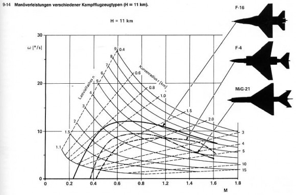

The F-16's E-M chart vs. the aircraft it was designed to beat, the F-4 Phantom and Mig-21:
We rehash this old history to stress the first point that the F-16 (and the F/A-18 despite whatever their monikers might claim) were designed to be air-superiority fighters and not attack aircraft or bomb trucks (more on this later). The F/A-18, with McDonnell Douglas's historic maritime expertise, became a delightful handler in carrier operations - landings were greatly eased by its low-speed handling thanks to the higher-aspect ratio (think wider rather than deeper) wings and twin-tail planforms. These (and the engine placement) also made it a ground-breaker in high-alpha nose-pointing ability, opening up new avenues in air combat.
