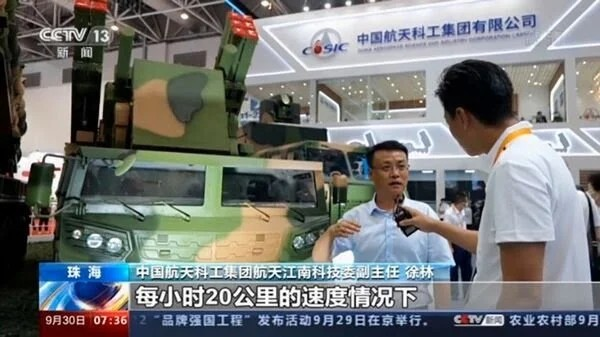

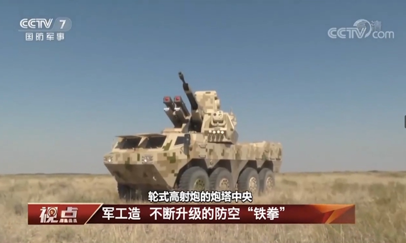

Rather interesting choices , should have included the FK1000 as well since that would have given the PA more flexibility since the FK1000 & FK2000 use same turret albeit with different type of guns ,
Also is the tracked Korkut that was tested part of a different program or this one.
A good option also to look at would be the HQ 17 E a true shoot and scoot AD weapon for armoured thrust with 360-degree area coverage and a range of 25km plus good altitude ceiling engagement.

Is HQ-17AE for a different role than these? Are we interested in that? Thanks.
I think PA wants anti PGM capabilities as well and while HQ17 may be able to engage them with missiles but PAAD can't afford to shoot down every incoming missile with another A2A missile,for that 25-30mm MG would be better(economical as well as being less prone to saturation).
