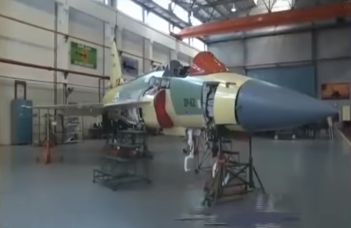

It was reported in September 2016 that Nigerian AF has decided to acquire JF-17. The initial batch of 3 JF-17N is expected to be delivered in November 2020. The first aircraft (2P-60?) was speculated to have been built by early 2020.
Why would they put apu intake up on the tail when it sits near the landing bay?
Isn't the exhaust for apu right in the middle of the landing gear, behind the gun?
That's probably a ram air inlet for oil or avionics cooling
