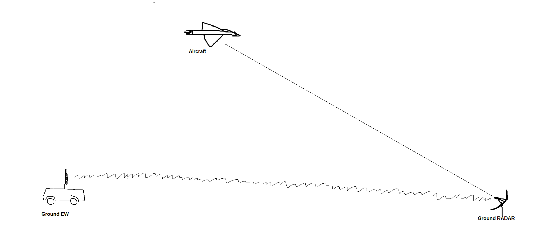

Excuse the bad drawing, but hopefully this conveys the point. Basically, in such geometry, any modern radar will have no issues acquiring the aircraft since it can simply filter out the Jamming because the Jamming and the Aircraft in question are at vastly different bearings wrt the radar.
Now, if the aircraft flew close to the ground that would be an entirely different story and in that case yes the Jamming would work and the aircraft will be screened. But SAMs are largely ineffective against terrain-hugging aircraft anyways.
So you are saying that It is necessary for the Jammer/EW asset at the same direction, Azimuth & Elevation of an aerial asset to be effective against the enemy Radar?
In your pic, your ground EW system will use barrage or noise jamming to overwhelm ground Radar which is trying to receive radar reflections from the aircraft. The ground radar will know its being jammed but will be unable to get exact bearing of aircraft or provide a lock-on through SAM because of jamming.
I drew a very old-school analog radar, but since we are talking about S-400, lets assume the radar in the diagram is a modern phased-array with good jam resistance and clutter rejection. Shouldn't it simply be able to filter out the jamming (as clutter)? Since the Aircraft and EW system are at vastly different azimuths.

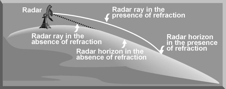

May be a silly question but could you comment
What would be the effect of curvature of earth on ground based EW equipments, because in case of radars it is said curvature of Earth limits the range of radar for low flying objects?
RF waves propagating within the earth's atmosphere do not travel in a straight line. The earth's atmosphere bends, or refracts, RF waves. One impact of the atmospheric refraction of RF waves is an increase in the line of sight (LOS) of the radar. This increase in radar LOS effectively extends the range of the radar.

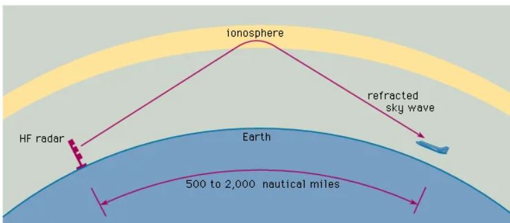

The advantage of the HF band is that radio waves of these frequencies are refracted (bent) by the ionosphere so that the waves return to the Earth’s surface at long distances beyond the horizon, as shown in below figure. This permits target detection at distances from about 500 to 2,000 nautical miles (900 to 3,700 km).

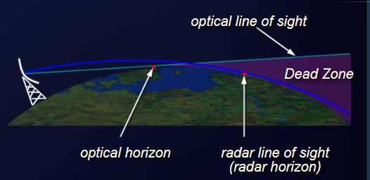

The electromagnetic waves follow the rules of the optics in higher frequencies (>100 MHz). The earth's curvature may prevent the radar seeing a target within the maximum range given by the radar range equation. Therefore results a "dead zone” for every radar system in which one targets can't be detected.
However in the earth's atmosphere, electromagnetic waves are generally bent or refracted downward. This reduces the dead zone but causes fault in the distance and height measuring simultaneous. In practice this is achieved by using a value of 8.5·10power6 m for the effective earths radius instead of real 6.4·10power6 m.
So this could be applicable to the ground based EW systems as well ??
