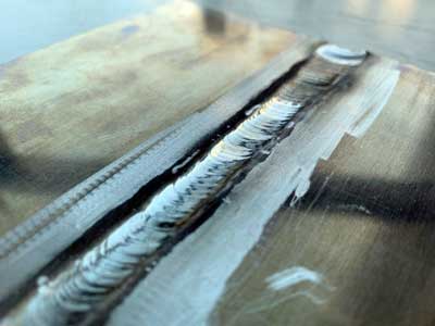

Now, engineers at the UCLA Samueli School of Engineering have developed a way to weld the alloy, known as AA 7075. The solution: infusing titanium carbide nanoparticles -- particles so small that they're measured in units equal to one billionth of a meter -- into AA 7075 welding wires, which are used as the filler material between the pieces being joined.

These are two pieces of aluminum alloy 7075 welded together using a nanoparticle-enhanced filler wire. (Image: UCLA Samueli Engineering)
Using the new approach, the researchers produced welded joints with a tensile strength up to 392 megapascals. (By comparison, an aluminum alloy known as AA 6061 that is widely used in aircraft and automobile parts, has a tensile strength of 186 megapascals in welded joints.) And according to the study, post-welding heat treatments, could further increase the strength of AA 7075 joints, up to 551 megapascals, which is comparable to steel.
