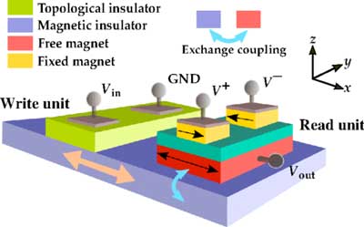

Copy and invert functions implemented with the VTOPSS. In the write unit, an input voltage signal applied across the TI layer causes spin accumulation at the interface of the TI and MI layers, which exerts a spin torque on the magnetization of the MI layer to reverse it. The read unit has a MTJ exchange-coupled to the MI layer that allows reading of the information in the MI layer. The polarity of the output voltage can be changed on the fly by change of the polarity of the voltages on the MTJ stack, allowing both inverting and noninverting logic to be realized with the same primitive/layout. (© Physical Review Applied)
