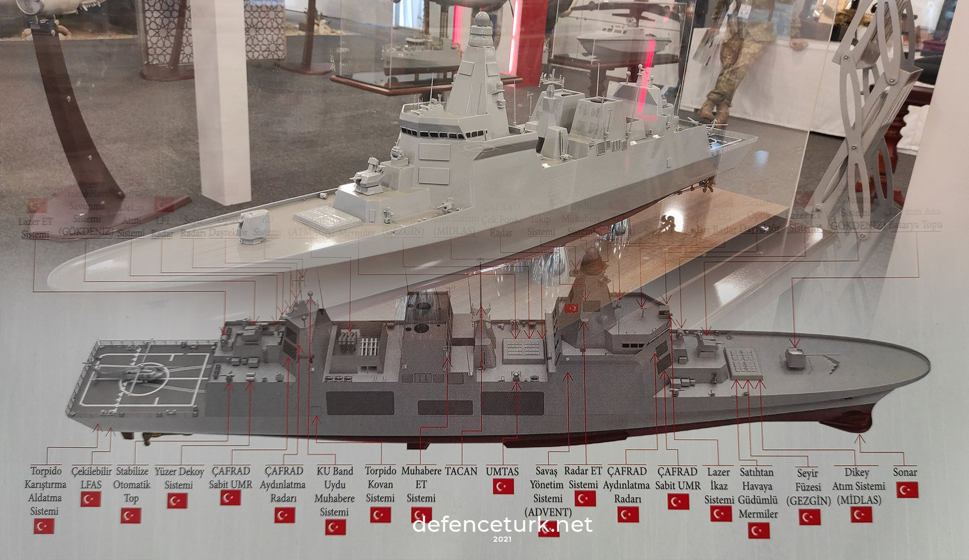

Jinnah Class Revealed
It can't be something the size of Nasar. At least Abdali size or may be Ghaznavi size..
Jinnah class doesn't seem to have the space to carry even one missile of that size.

JINNAH , Class Frigate will be a beauty :pakistan: :turkey:
Seems to have sufficient weaponry

It is a Total Package , something we need a ship better then OHP Class , modern Locally manufactured ship we can rely on to enhance and grow. The OHP did not come with All Gadgets so we need to fill the gaps where they exist
Unsure why it would be tied to Milgem Delivery Schedule it is a unique project, would be nice if we can get this ship along with Milgem Units
Difference between 16 VLS or 32 VLS is not that much of a big deal we can easily get x4 Jinnah Class to compensate in future

So, seems like Jinnah's class might be a Light Frigates similar to F-22Ps.

Ship looks like 3600 - 3800 tons category warship.
An enhanced Babur class to say the least.
2X ASROC, 1X76mm, 16X VLS SAM, 4X2 AShMs, 1X CIWS, 3X2 TTs (of course), and flight deck (10+ tons?)
I was expecting 4000+ class warship with 24 VLS and 16 AShM :D
Still, for it's weight category, class and role, it's sufficiently equipped.
This is SAAR 6 or Israel navy. Even though it is just 1900 Ton ship.. yet it's weapons package is second to none. Why can't we atleast have a quad pack 16 cell Vls on 3300 ton Jinnah with 12-16 AShM ? Even if Jinnah doesn't have quad pack, comparing to Saar 6, it should atleast have a 32 cell VLS. We should had quad pack Vls on even Babur.
