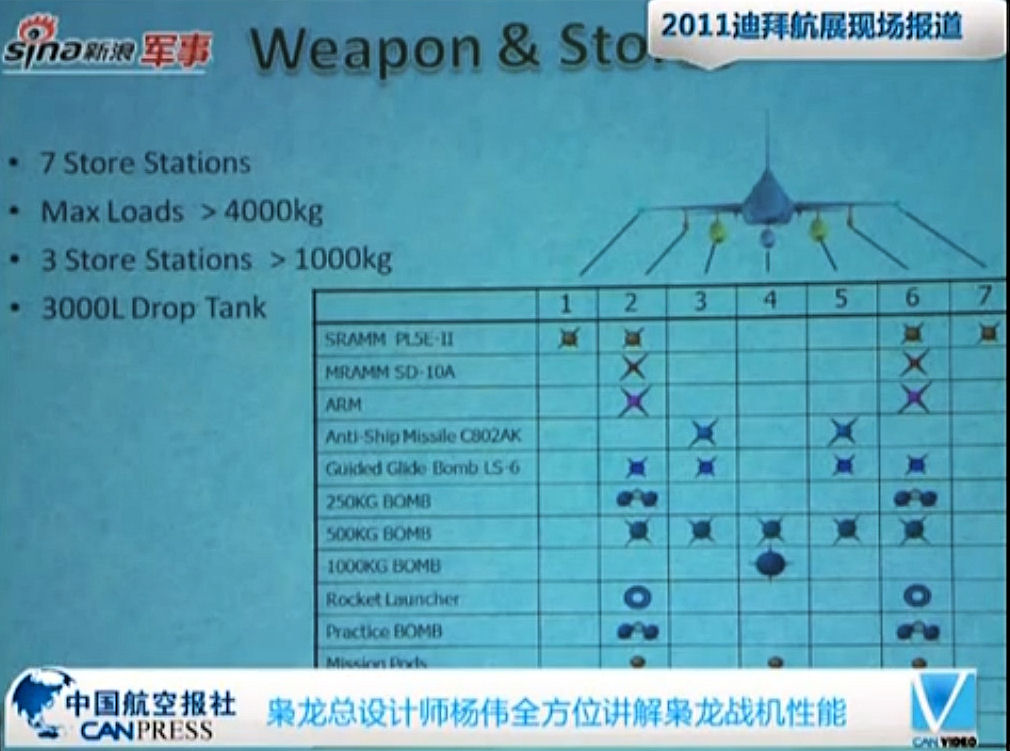

It was in 2011, presentation of JF-17 stated that 3 centerline hard poins have limitation of max 1000 kg
These are Blk-1 values since then there has been news that stores have been reinforced for more load and its being implemented in older aircraft. Maybe someone can find and post
3 stores are each rated more than 1000 kg the largest load is 1100 litres drop tank with pylon and drop tank weighing almost 1200 kg
