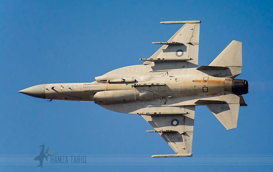

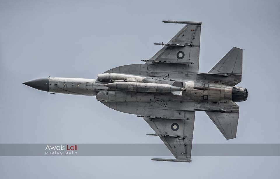

Dual seater and block 3 with extra 1 meter wingspan, best options is to strengthen outer wing and add additional under wing station just for sd-10 class weapon
Even existing block have enough clearance it’s just strengthening outer wing to add new pylon
With two more under intake this will being jf-17 to f-16 comparable number of stations and configuration
Otherwise in air to ground mode jf-17 can only carry short range aam unless you loose underwing droptanks and only carry under fuselage drop tank which means less range
Last option just upgrade outer wing to strengthen it so jf can carry sd-10 on wingtip
Remember paf original option was to go for mica a 110 kg aam vs 200 kg sd-10 which could be handled on wingtip

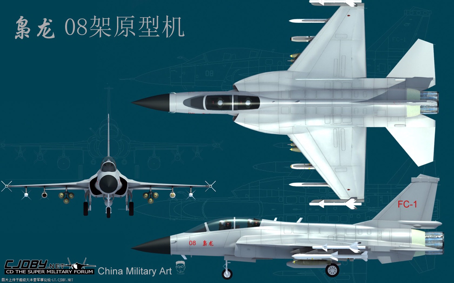

The drawing is just fan art. Nothing to be taken seriously
