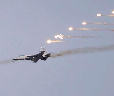

like i mentioned it before as well, those stains came from OIL drains, not Fuel drains.

And this is a PT-04
you can see the flares are installed, or at least that yellow cap is gone.
It is odd why PAF still hasn't installed chaff/flares on it.
Fuel system is a very complicated thing, but i assure you it doesn't work the way you suggested.
And this is a PT-04
Sir ji, with all due respect I'm pretty sure its Photoshop
there is no place for flare dispenser on top of the fuselage.
unless you can prove me wrong other (which i hope, it would be good for jf-17)
I was given this picture by someone credible. I am not sure if its photoshopped. The jet is descending which is why the flares look like being dispensed above.
