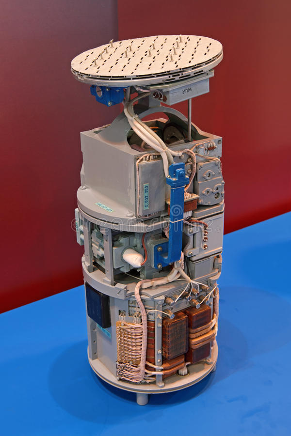

I cant find Fakour 90 seeker image, I am sure it is Already posted somewhere here. But here hate few ARH seekers vs SARH... SARH since it is bistatic arrangment where missile has only passive reciver has very different head,while ARH looks as standard airborne radar, which in way it is
First is SARH, rest ARH

Fakour 90 seeker, I Will find image I have it... It is exactly same image Like this one, Just little different , this is also ARH seeker, but 1st generation...

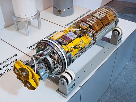

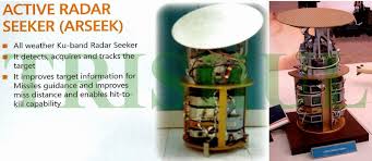

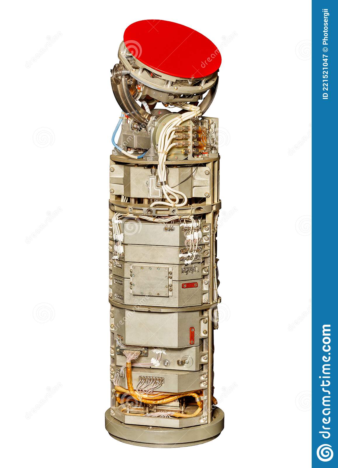

I found some old images, now I Will post Iranian ARH and SARH seekers and Russian ARH and SARH seekers for Buk and A2A missiles just for comparation
First 3 images are Iranian seekers, there are ARH seekers(on right side) and SARH(left) ... And 4th one is Buk SARH ,5th and 6th ARH
Here is good comparation of two seekers for Buk, built by Agat... Left SARH
( 9E420 digital CW dual plane monopulse semiactive radar homing seeker)
On right:also Agat ARGS monopulse active radar homing seeker for Buk missiles
