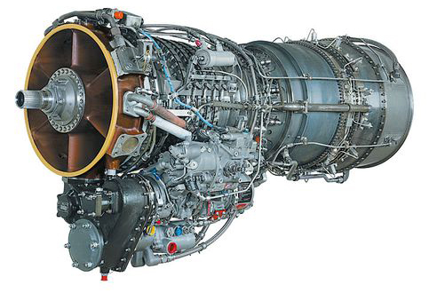

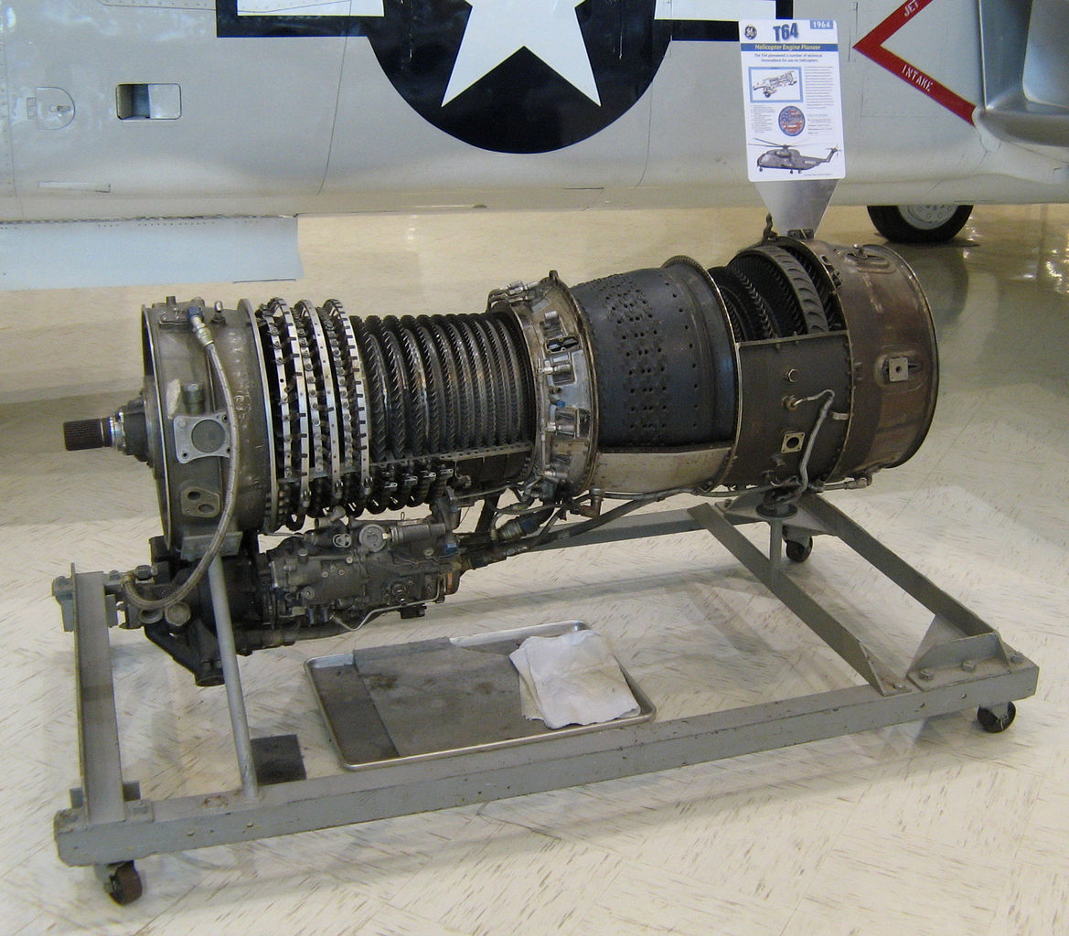

guys i found something interesting, general electric T-64 engine which powers our ch-53 helicopters, has turbine inlet temperature equal to max 800 centigrade degrees, on the other hand we know that general electric j85 engines that we make under the name of owj, has turbine inlet temperature equal to 977 degrees, so i assume hypothetically we can make something like this right??
just look at this babe:wub::wub: if we manage to produce something like this, it would pave the way to produce our own ch-53 and ch-47 or even gunships.

turboshafts/props are basically a turbojet with extra independent turbine stages. what really matters is the turbine inlet temperature also they have more compressor stages to supply fresh air to combustion chambers.
