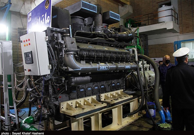

Unveiling and start of mass production of Iran's first fully domestic naval diesel engine dubbed "Macran 3600".
It's been developed by science based companies, has 3600 Horse power and can provide 30 knots speed for our Sina class vessels. design of heavier engines has already finished too.

thanks for sharing the news, but hadn't they claimed that the Bonyan-4 (5000 hp) was the first Iranian naval engine?
which has certainly already been installed on the Dena frigate
The Bonyan 4 would`ve been the first indigenously manufactured iranian naval diesel,but its pretty clearly a reverse/reenginered MTU type.
The new makran is claimed as being both iranian designed and manufactured.
