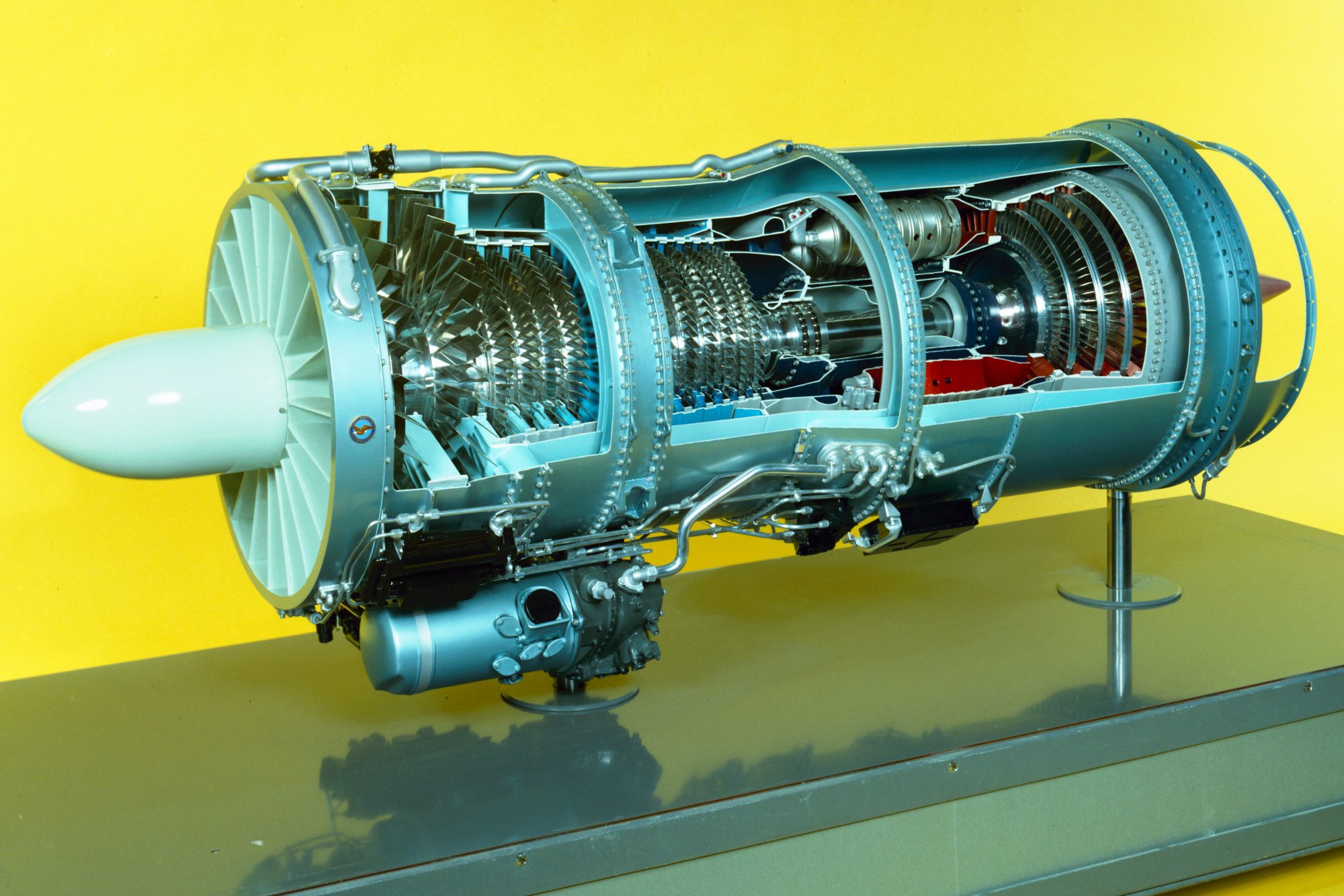

Al-21 is incredible fuel efficient for a turbojet that is to work at low altitude.
R-35 has thrust levels of F-15/-16, but already is a twin shaft turbojet with added complexity.
J8TD is something Iran already went the technological path for its MD-8X fleet. Such an effort wasn't done for the D-30.
I would also absolutely not recommend changing the how section, but a change in fan and LPC could be sufficient, together with an compact afterburner.
So never touch the hot section, this would make the modification a complete re-design.
With 60's J8TD you also avoid somewhat the technology trap you correctly mentioned
Also we are not fantasizing here. If Iran selected to produce virtually all parts of the J8TD for the MD's, I expect a secondary agenda to justify that effort.
We both know how incredibly difficult it would be to copy an engine without the original documentation.
If Iran went that long way to do it, I would expect that a military application was also envisioned.
Given Volvo RM-8, that would be a good motivation.
Current situation is that Iran feels its industry is capable to take on a mega project such as reverse engineering a beast like CFM56.
Its already serial producing those little simple J85 and soon wants to add an advanced, but small, turbofan like the FJ33.
1960's tech. JT8D for the MD fleet and F-4/-14? Without commercial costs pressure?
Certainly nothing certain, but it would make sense.

PS: Good to see another Iranian who made a successful carreer abroad!
Love your idea here, and I hope Iran can do this as you hope for.
But I see a few things that concern me.
First, if Iran is going to put everything it has into a CFM56-5 mega project, then I would ask them to also use the core to develop 30,000lb thrust F101-GE-102 which would be an incredible turbofan engine for Iran's fighter jets or even future bombers. This baby has an SFC that you want at about 0.6 and it is a very reliable engine from what I have heard.
Why then do TWO projects? one CFM56-5 and one JT8D?
These two engine cores are totally different technology generations. It's like building a 1960s compact car and a 2010 executive car. Does Iran need to have BOTH of these projects running while it is cash strapped? I am not sure.
I rather Iran have one engine development project and one air-to-air missiles development project focusing on building R-33/Meteor/AIM120/P12/P15.
AESA radars and good missiles are more important than close-range dog fighting capabilities in all-out wars. Any pilot I have listened to before have indicated to me that they don't necessarily want to hit the afterburner to go full speed to f-pole to engage. Afterburner to an opponent has its issues, depending on altitude and launch platform. Pilots don't often want to furball it if they can avoid it. They prefer to fox III launch a missile or ideally long range BVR R-33 and firewall out to RTB, as they say.
With satellite radars and long range radars, furballing would happen less and less. May be long gone those days that a pair of F-14Ds shoot down Libyan Mig-23s at close range. In all out air war, it will be many-on-many. Meteor somewhat has redefined air combat a little. What will happen more often is ambush.
AIM120D has a range of 190+ km at 35,000 ft altitude although they say the range is only (b.s.) about 160km.
Another thing, Iran is very familiar with twin-shaft. It is something they are perfectly fine with.
Either way, I just hope they can FINISH sometime to a degree of reliability that is industry standard and acceptable, AS SOON AS POSSIBLE.
And also hope if they go the route of JT8D, the final turbofan is not as heavy as a single spool Volvo RM8.
Heck, I'll be happy if they build a copy of J79.
Iran has EVERYTHING it needs to reverse engineer J79/AL21F and R35. Everything it needs, even alloy composition. That one I assure you. Iran has no one that is larger than life and take on this project, or they think they don't and don't agree with him, at the moment. He is in Iran and trying but what he wants is not something Iran is so far willing to give him. He wants his own old team moving to Iran.
Iran AF (or any aspect of Iran), NEEDS A WIN to motivate them They have had very few wins lately.
Great ideas you have. Hope they come to fruition for Iran and all of us.

The issue with the CFM56 project is, that's its still several years away. But it would certainly make the better core, see WS-10.
JT8D was claimed to have been reverse engineered 6 years ago.
They apparently needed to at least rebuild existing ones for the MD8X fleet, hence its already there and mastered.
But was the MD-8X fleet worth such a effort? I doubt it.
But combined with re-engining F-4 and -14 it would make more sense.
Could also be nonsense, but Manuchehr Manetghi is not a nonesense guy but probably the most capable man Iran has in that field.
I fully agree with you on that AAM emphasis. Yes, airplane kinematics can be compensated by a long range AAM.
Iran is certainly doing so, as its only BVR missile is already a kinematic giant, Fakkur-90.
So they are aware that they need more than something in the AIM-120 class to compete with their inferior fighters.
Also those 160 or even 190km ranges for AMRAAM are ideal values which will never be reached in actual combat.
Even half of it is often optimistic.
