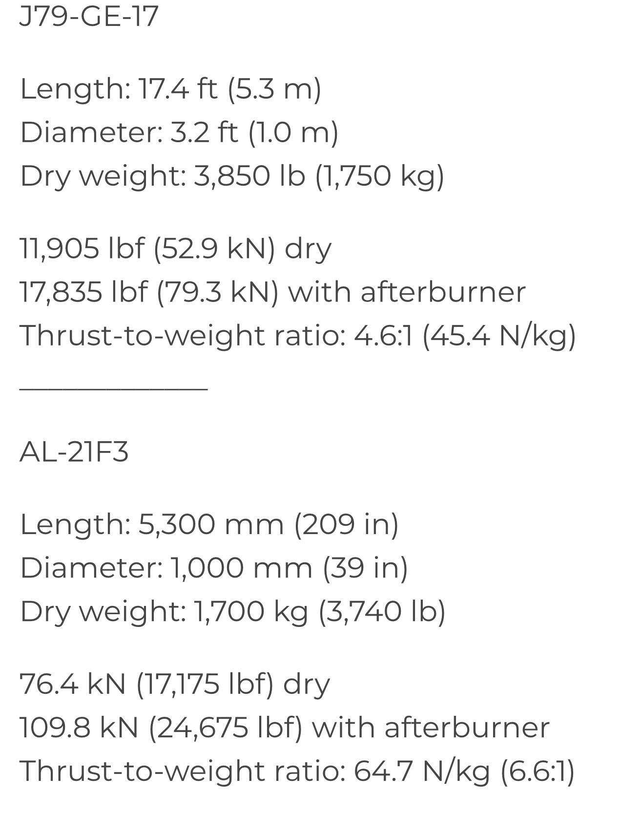

Al-21F is basically a modern copy of J-79 engine based on the samples captured by Soviets from the crashed Phantoms during the Vietnam war. It is an excellent choice to replace J-79s, as well as supporting the grounded fleet of Fencers. It is superior to J-79 almost in all aspects.
I agree, it is superior in every way. As I mentioned before (in a response to PeeD), Iran can easily fasten these into F4s instead of J79. Iran also has had long record of use and maintenance of AL21F (Su24).
This is a simple project, does not cost a lot, and it can make a major difference in range as the 17,000lb non-afterburner thrust is quite sufficient to avoid using afterburner and wasting precious fuel. Which is almost the same as J79 WITH afterburner.
My logic behind this comes from years of analysis. Iran has a great workhorse fleet of F4Es and a few F4Ds, it makes sense AT THIS POINT (not a few years from now), to keep these operational and even enhance their performance temporarily until Iran can get a decent replacement for the next 20+ years.

But for certain functions, still F4 is a great aircraft. If it has extended range (AL21F would help, and two bolt on fuel tank on top by the fuselage would help), then it can carry 3 anti-ship missiles which force an adversary to MAKE PLANS AROUND that kind of threat/scenario.

Iran more than anything needs STANDARDIZATION in engines.
The LTC4B-8D (a great engine for Iran's hot and high) is another perfect example. Iran can use this engine for heavy attack helicopters, for medium transport helicopters, even 2 of these for something like a EH101 or CH148 for the Navy.
This engine is a derivative of the same engine in CH53D.
Standardization is key for Iran to keep costs down, keep maintenance under control. Even if these engines are not fuel efficient, so what? Iran's biggest problem is not fuel access.
