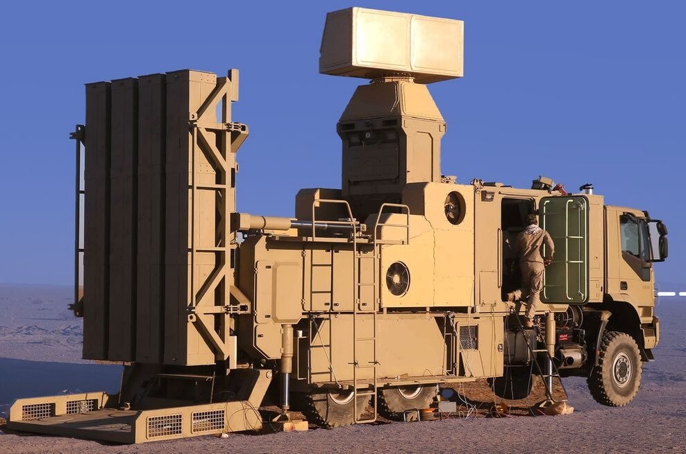

by the way here it's stated that the system can control 8 missile but they only put 4 missile there

As I said the system have datalink for 8 missile but only carry 4
And this is point defense system not a system for axample like 3rd of khordad this system have one unit per battery
