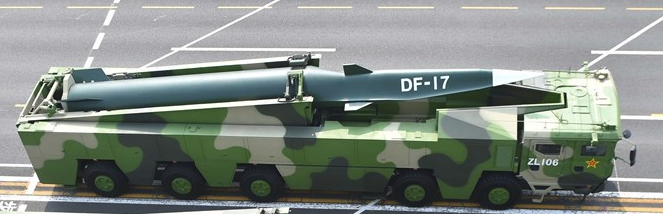

The P282 might look something like:
or even something like the CM-400AKG
So it's really hard to say what type of system it is.

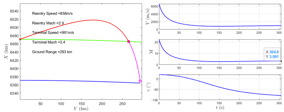

No they do not. You might be confusing the speed ballistic missiles achieve "outside" the atmosphere with terminal speed - which are very different things.
I did a little simulation for a Ghaznavi-type missile. I am sure you consider Ghaznavi a ballistic missile. Here's what you get:
The green line shows the Karman line. Blue line is the surface of the Earth, while the red and magenta are the missile trajectory. You can see the maximum Mach around 20, which is of course because the speed of sound being so small so high up. At 10km altitude the Mach is 3. Not hypersonic.

The geek in me is loving these. Could you please give me a 'teacher's explanation' of the simulation? I've been looking for books to help me get started on the flight dynamics of guided rockets/missiles, but i haven't found anything, courtesy of ITAR probably.
An overview of the governing equations used here would be most helpful.

To be fair, the Mach 6 figure in the above book is based on some obscure interview (You can check the references at the end of the book). It may be accurate to assume that the number is false.
The Scud can at best be classified as an early generation MRBM with a ballistic coefficient that gives it a terminal velocity similar to that calculated by @JamD for a Ghaznavi-like missile which can be also be classified as an early to mid gen BM.
The terminal velocity (in the most basic terms) depends on the weight of the missile (or atleast the part of it that is flying towards the target i.e. the re-entry vehicle). So, even if the RV re-enters the atmosphere at hypersonic speeds (>Mach 5), it will actually slow down post re-entry to attain the terminal velocity which would probably lie within the above mentioned range for the type of missile you mentioned.
