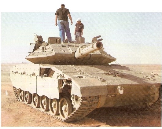

'Trophy uses an MEFP warhead, which requires a rather uncontrolled form of detonation. As the body of an EFP needs to be made of metal (with a thinner, shaped front plate), there will always be fragments of the steel shell flying to all sides. To prevent the blast and fragments from damaging the tanks (optics, anti-air machine gun, smoke grenade dischargers) or wounding the crew (when operating above the hatches).
To fix this, Trophy is fitted with a blast shield made of steel. This is fixed to the tank, though I am not sure if this can be folded down like a hatch or retracted. The blast shield prevents Trophy to be turned around (althought the general layout of the Trophy system with launchers located at the turret sides), so each launcher covers only about 180-220° of azimuth. This means, that it is not possible to use the left launcher to defeat any sort of missile coming at the right side of the tank. If one launcher is reloading, the other one cannot cover the tanks side. If two or more RPGs are fired at the same side of the tank at the same time, one launcher is not enough to stop them.'
Blast shields for the MEFP warhead creates blind spots, you can clearly see how with this model.
exactly what i was thinking trophy is not a 360 degree protection system but question arise can top attack missile exploit its weakness or not.don't know about spike or javelin but tow 2b most probably will be intercepted because of its low flying before it can reach top of the tank.
(as shaped charges lose its effectiveness if there is significant distance between detonated charges and target hence need for low flight)
thanks for the detailed reply bro spike truly is a remarkable missile against tanks with ERA and RHA. just want to ask you one more thing is it or for that matter any top attack missile is effective against active protection systems.
No current ATGW (direct attack or top attack) is designed to defeat APS because current ATGWs pretty much predate the advent of any functional APS. But that doesn't mean they couldn't. E.g. if you know for a fact that APS system X has a blind spot in coverage, what's to stop you from applying your old ATGW right there. Top attack ATGMs like the ones we discussed attack the tank (turret) top, requiring the active protection system to attack nearly vertically, for which the APS hard kill element might have not been designed. The same is true for an RPG being fired in a steep downward angle from an elevated location at a target below.
Also, one would neet to know WHICH active protection system, as they are not all alike.
Ok so here we are over on the front left side of the Merkava 4 with Trophy, when viewed from the tank. The tank's left hard kill launcher can clearly hit us at this angle. But the right one clearly too. This suggest the two field over fire clearly overlap well, to the front. But, we are at some distance from the tank (so the closer in we get, it may be more difficult to achieve that overlap, as the turret and blast shield will get in the way.) and also we are a bit above the tank (so, the lower down we are, it may be more difficult to achieve overlap, as the hull front and gun barrel will get in the way)
Similar but over on the other side of the MBT. I don't think there is a coverage gap forward.
Frontal shots, closer in, from lower angle for comparison.
It would be nice to know the diameter of the circular coverage i.e. how far out from the tank are missiles supposed to be killed. Is this the same all around ?
In Bill, the downward firing charges are angled, relative to one another and fires sequentially in such a way the the first charge hits exactly the same spot as the second. One fires slightly backwards, the other straight down. The Bill and TOW 2B missiles overfly the target at a set height. These missiles come in horizontally, at a little more than the tanks overall height (say, 4m of the ground). Spike and Lahat don't do that, they dive onto their target from above at a shallow 30 degree or not so shallow 85 degree angle. They make contact at the nose (i.e. zero distance between missile and tank)
Rear area coverage may be more problematic due to the turret bustle. But again, the hard kill takes place some distance away from the vehicle.
Of course, the hardkill system is mounted on the turret, so any coverage gap to the front or rear of the turret moves along as the turret turns. Where - if at all - the hull is not protected depends then on turret position.....
[start edit] I believe the Trophy systems at least gives warning of incoming ATGW, so it may be possible to - manually or automatically - slew the turret to a position that provides optimal coverage. [/end edit]
Atleast from what I heard,Trophy gain control over the turret if needed. Also self reloading capability is very very fast, and the chances u'll shoot couple of missiles at that "gap" is almost zero, and destroying the tank is even lower.
It does not take control over the turret if needed, because it's actually not even needed, for each warhead has ~210 degree of action - they are overlapping into each others covering territory.
