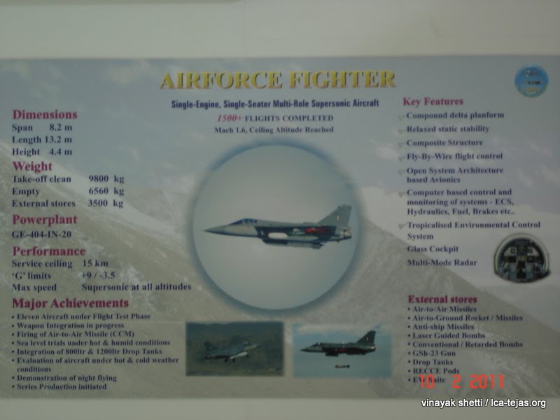

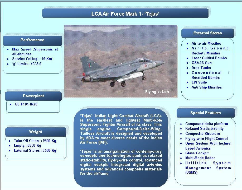

Nope, the reports around IOC 2 stated 6 to 7G and 22 to 24° AoA, which they need to improve. Earlier specboards showed 9G as the limit too, so this might be one of the performance limitations of the MK1, that needs to be fixed in the MK2.
P.S. ADA specboards from Aero India 2011 and from their website:
View attachment 193185 View attachment 193186
What will be drawback of limiting to 8g than 9g ??
To maintain the structural integrity.
So if it goes to 9g , the structure will disintegrate ??
It will not be able to do the full range of maneuvers, since the FCS limits the pilot. It's usual to slowly expand the flight profile of new fighters and if the 8G and 26° AoA will be reached with the MK1, it's still a good achievement. The latest figures in the brochure confirm 24° achieved so far for the MK1 and 9G as the aim of MK2.
