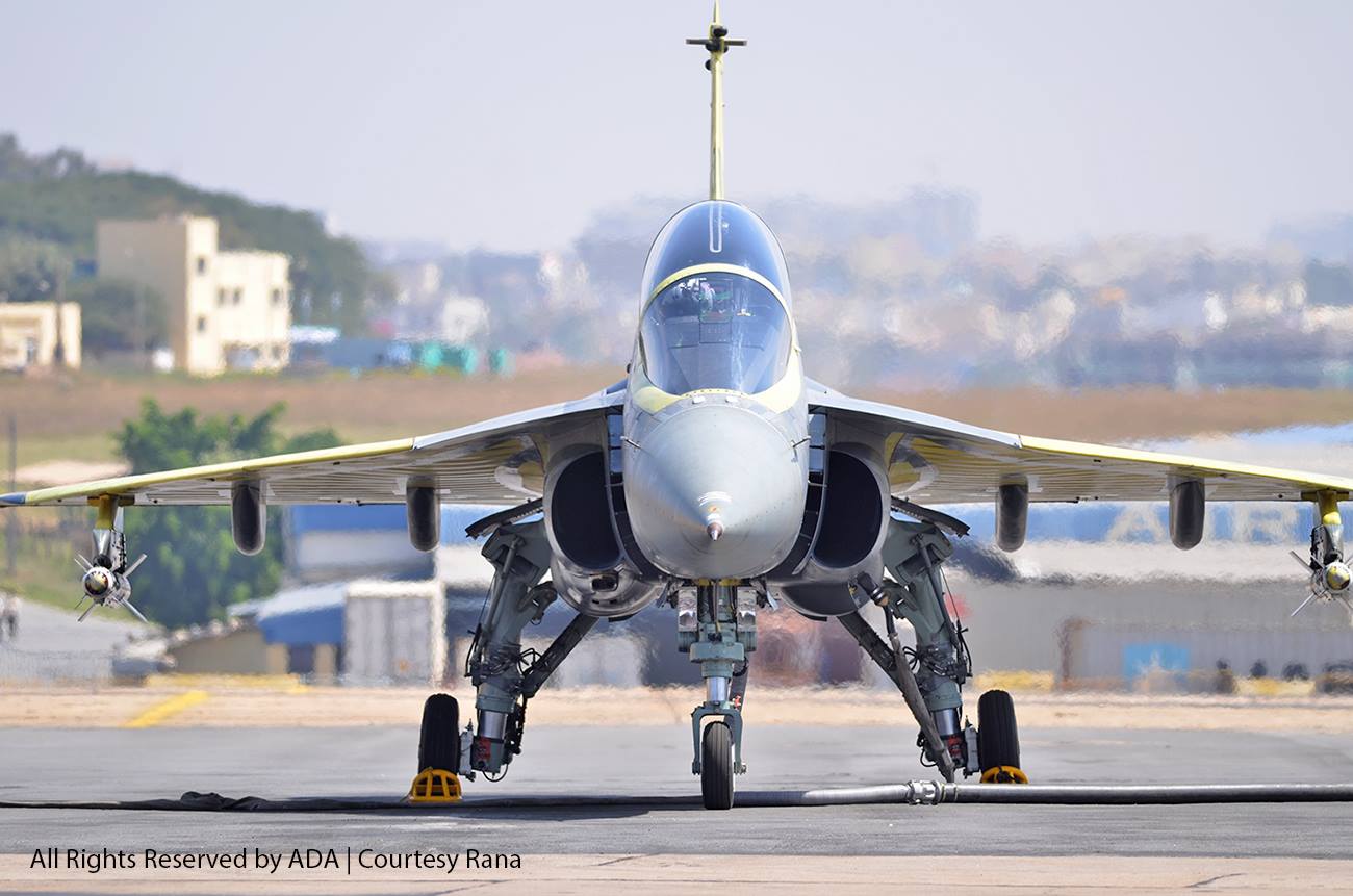

From this angle you can really see how over engineered that landing gear is on the NLCA at the moment.

I don't think it is over engineered...
Nah, it probably is. And for good reason too. It's quite common to over-engineer a prototype, to add a certain extra layer of safety if you will. As more and more test data is collected and analysed and the exact parameters of loading and shock the structure will have to undergo, the prototype is slimmed down.
I've seen far simpler, and cheaper shock absorbing systems, and subsystems being over-engineered to a factor of safety 6 or even 9, when perhaps 1.1 or 1.5 was required.
When I say "over engineered" I am directly quoting the chief test pilot of the NFTC:
For the Mk.1 the LG were over engineered a) because this is a prototype but more importantly b) because the IN had little say in the design of the Mk.1 (which NP-1 and 2 are based on) so there has been little strengthening of the actual airframe for the NP-1/2 meaning a grossly over engineered LG needed to be designed to absorb the impact itself without passing the load into the airframe. The IN has had more say in the Mk.2 so this extreme LG won't be needed.
