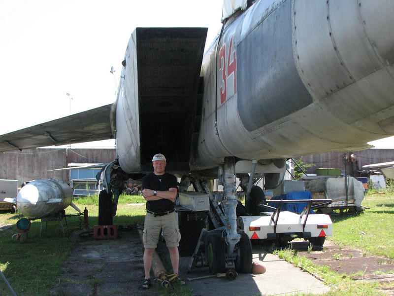

The Mig-25 produced only 22,400 lbs thrust in afterburners and it has the biggest intakes of any single seat aircraft.
Intake size and the intake channel are two different things. The intake channels in serpentine designs is not as large as the intake suggests.
And don't forget the air bleeding vanes on the air intake which varies volume of air flow into engine.
I would like to compare apples to apples.
The MiG-25 is an interceptor, powered by turbojet engines, designed in the 1960s. It had variable geometry intakes with adjustable intake ramps to regulate the speed and volume of airflow, and shock wave formation.
The Tumansky R-15 engines are massive.
Type: Afterburning turbojet
Length: 6,264 mm (246.6 in)
Diameter: 1,512 mm (59.5 in)
Dry weight: 2,454 kg (5,410 lb)
https://en.wikipedia.org/wiki/Tumansky_R-15
The MiG-25 was big all the way through, from intakes to nozzles.
The turbojet engine had very high fuel consumption, which requires large amounts of air.
