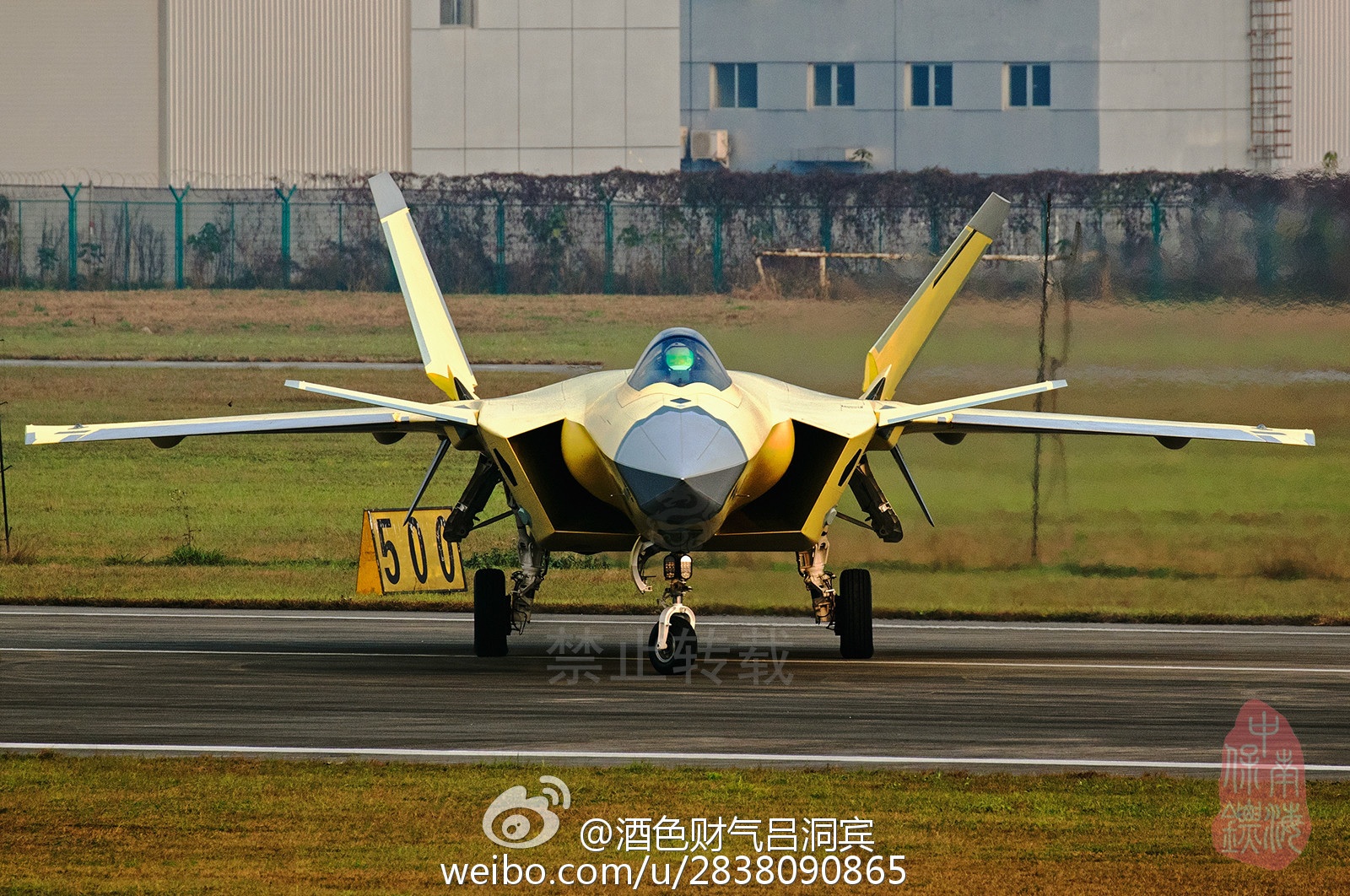

Hello, Sir. Hope everything's well with you. I was wondering if you could answer a small question. How are these new clipped stabilizers of J-20 and J-31 more stealthier than their predecessors? This alteration is unique to Chinese designs. US did something similar with F-22 but limited to wings only, not applied to the vertical stabilizers.
Let us return to the basic rules in designing with intent to low radar observability.
Control of:
- Quantity of radiators
- Array of radiators
- Modes of radiation
The question you asked is not small. In fact, it is tactically significant and if done incorrectly, the 'low' part of 'low radar observability' will increase.
In the simple example above, square 1 have four sides and four tips for a total of 8 edge diffraction radiators. Square 2 have five sides and five tips for a total of 10 edge diffraction radiators.
The initial impression would be that S-2 sort of 'violated' rule 1 (control of quantity of radiators ), but if these radiators are positioned in such a way that any edge diffraction signals are redirected away from source direction, where the radar signals came from, then S-2 is in compliance of rule 2 (control of array of radiators) despite having a higher number of radiators. The modes of radiation, edge diffraction, is the same for both squares.
I used the word 'violated' quite loosely here. It is not so much a violation of any rule but rather more or less compliant to them. A sphere have no edge diffraction radiation because it has no edges and tips. A sphere have specular and surface waves modes of radiation. Put absorbers on the sphere to control those modes of radiation and we might just have the ideal 'stealth' body.
So now take a look at the F-117 cockpit region...
We see edge diffraction signals all over that body because of all those sharp ridges. This body seemingly is not very compliant with rule 1: Control of QUANTITY of radiators.
But this body is very compliant to rule 2: ARRAY of radiators.
That compliance, or obedience, to rule 2 is so good that the F-117's RCS remain secret to this day. Array of radiators is where we see those famous serrated features, large and small, at the edges of the flight control surfaces, fuselage, and engine nozzles.
The rules mean that if we FIRST control the quantity of radiators, we would worry less and less about how to array what we have, and less about what kind of radiation that comes from what we have.
The opposite is true that the more quantity of radiators we have, the more complex the problem of how to array (position) them, and what modes of radiation there might be, so less signals will return to the seeking radar.
Why do one J-20 have modified vertical stabs but another does not ? I would dare guess that some tests on these structures indicated that there are 'stealthy' benefits to those modifications without adversely affecting aerodynamics and controllability issues.
The 3 basic rules on designing a 'low radar observability' body must be taken at the same time and when there is a major item like a flight control structure that protrudes into space, therefore fully exposed to incoming radar signals, even cropping a corner requires close study. Whether the American design needs this modification or not is based upon the same three rules.
I know my answer is long but it cannot be otherwise.
