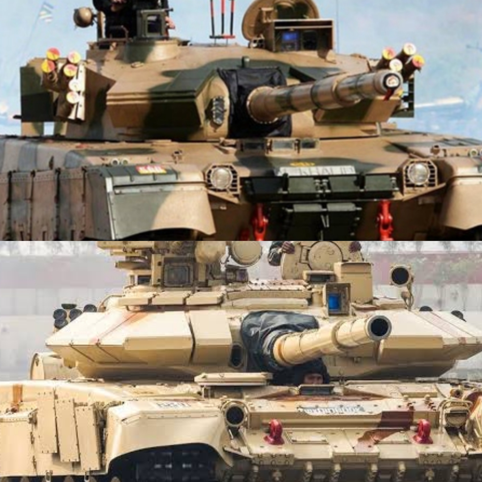

The coverage of ERA on frontal turret arc is poor with numerous exposed areas. Not to mention that ERA is missing from Hull front and sides. (no ERA on turret roof either).
Shown below a bit comparison of Al Khalid with T90S. (Pic not for you but for understanding of other members)
True

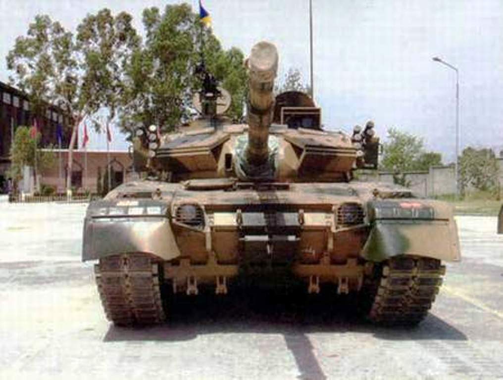

The coverage of ERA on frontal arc is poor with numerous exposed areas. Not to mention that ERA is missing from Hull front and sides. (no ERA on turret roof either).

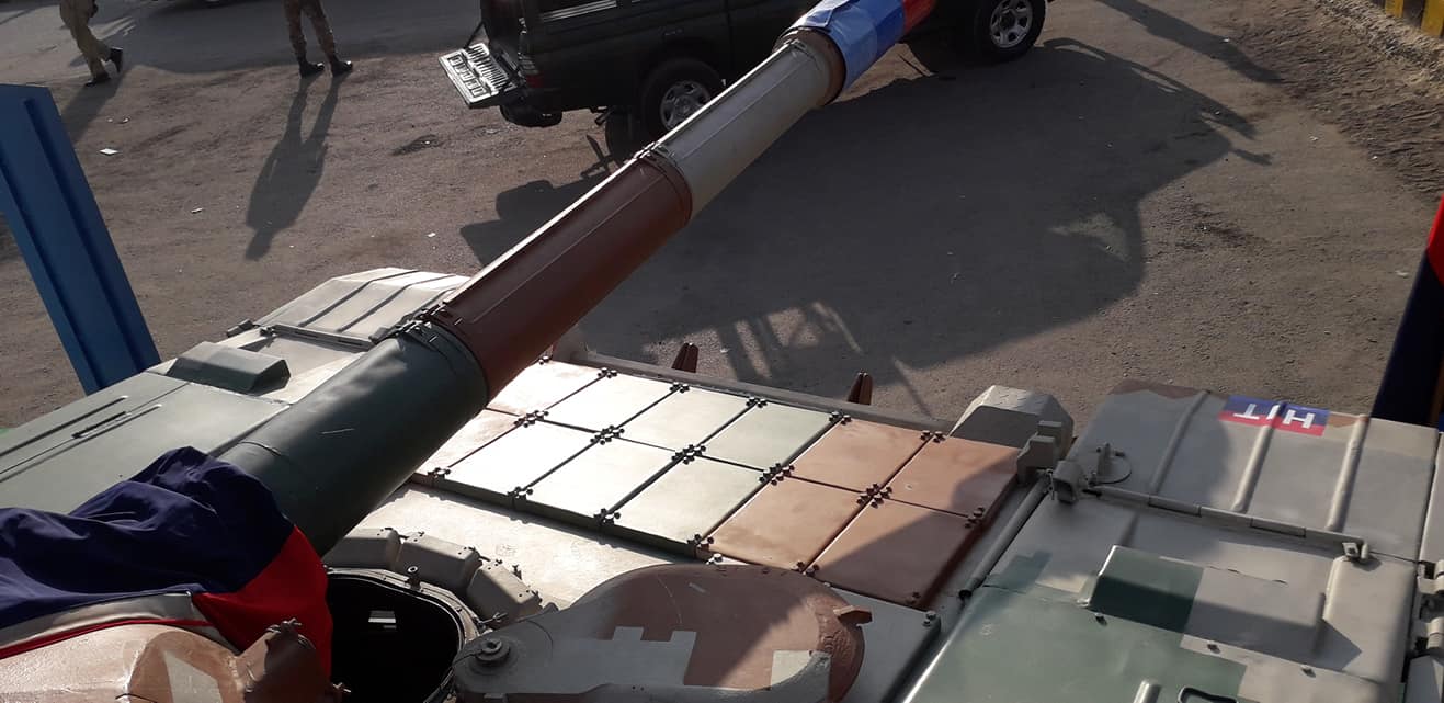

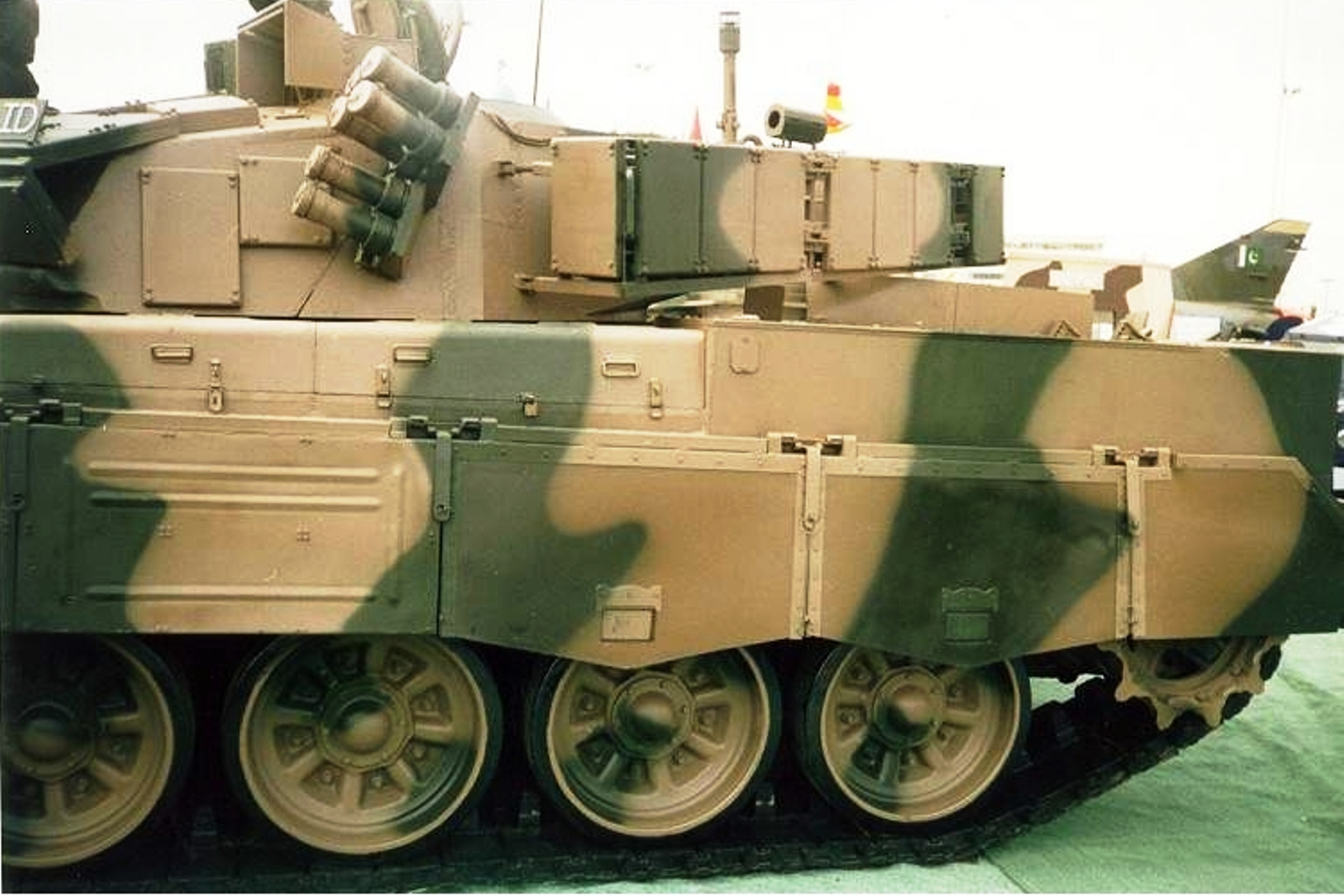

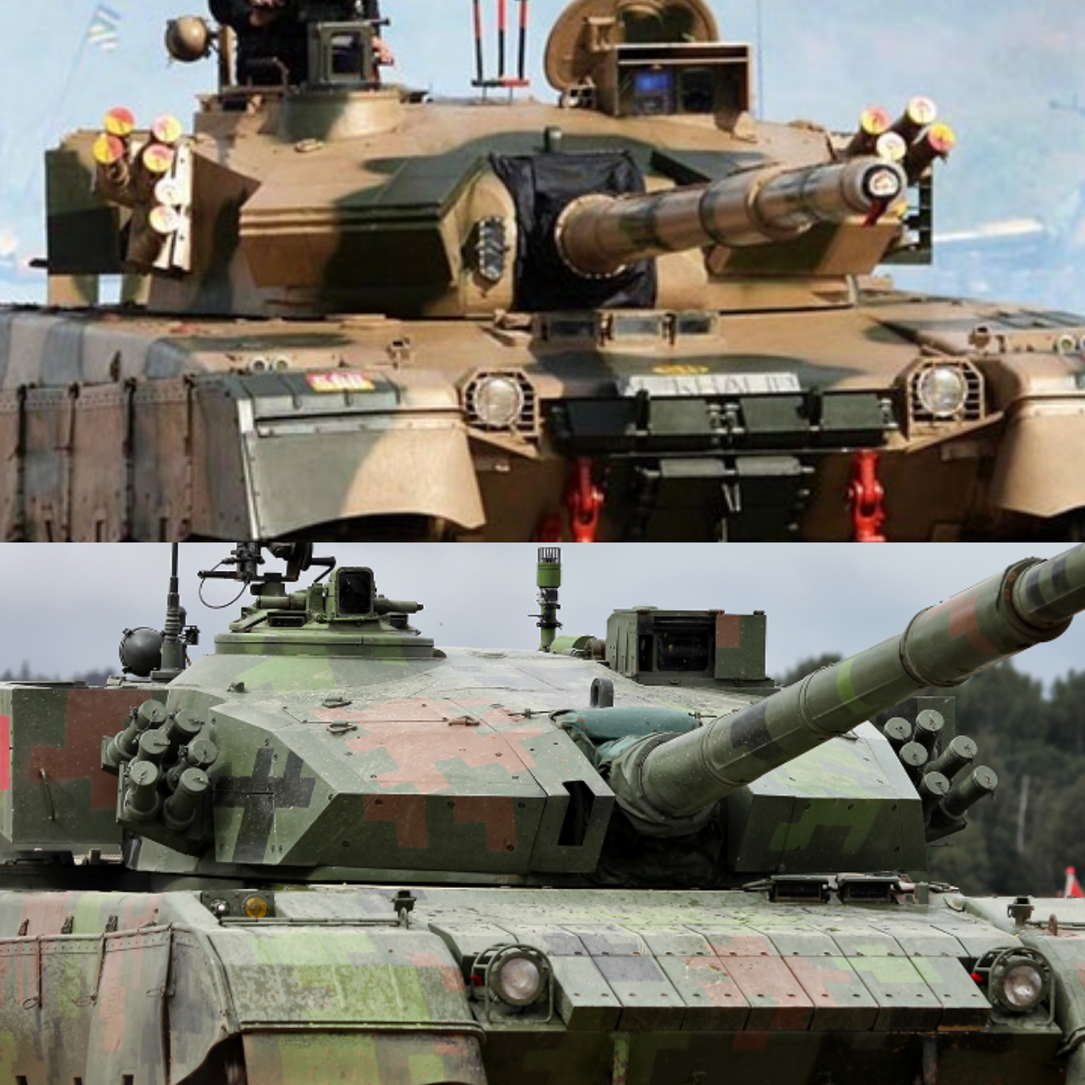

Yes there are some models displayed with much better ERA coverage than the ones which are in operational use. Problem is, majority of forward deployed AKs are not like that.
Plus, the gaps in front arc of Turret are very obvious even in those 'up armored' AKs. For example, notice AK Turret front ERA coverage with that of Type 96A.
You can easily spot the difference in ERA coverage on hull front also.
Interestingly, none of Tanks of Chinese origin have ERA coverage on sides of Hull.

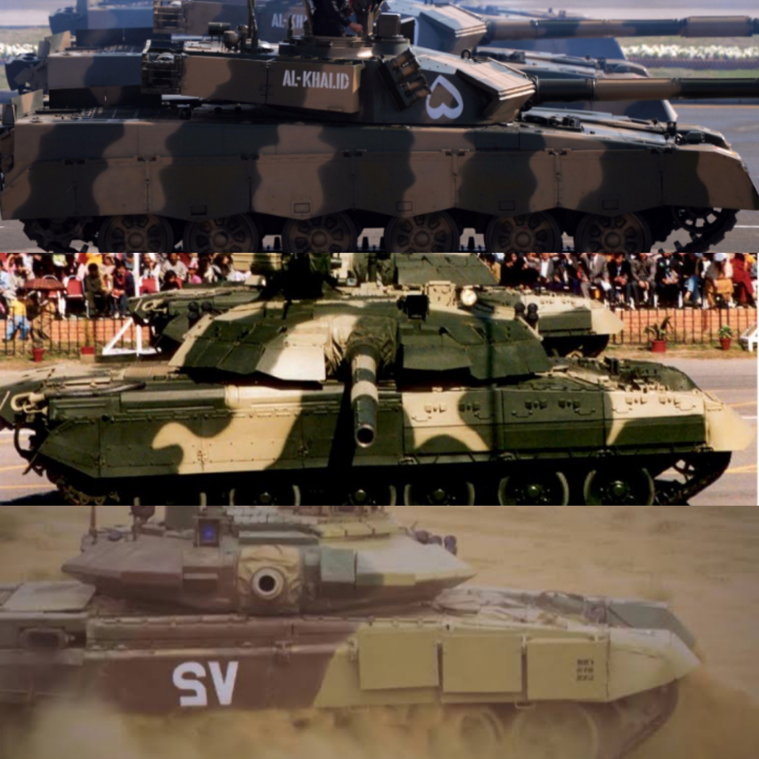

Shown below are sides of AK (no ERA), and T80UD & T90S (ERA plates)
Plus, the gaps in front arc of Turret are very obvious. For example, notice AK Turret front ERA coverage with that of Type 96A.
